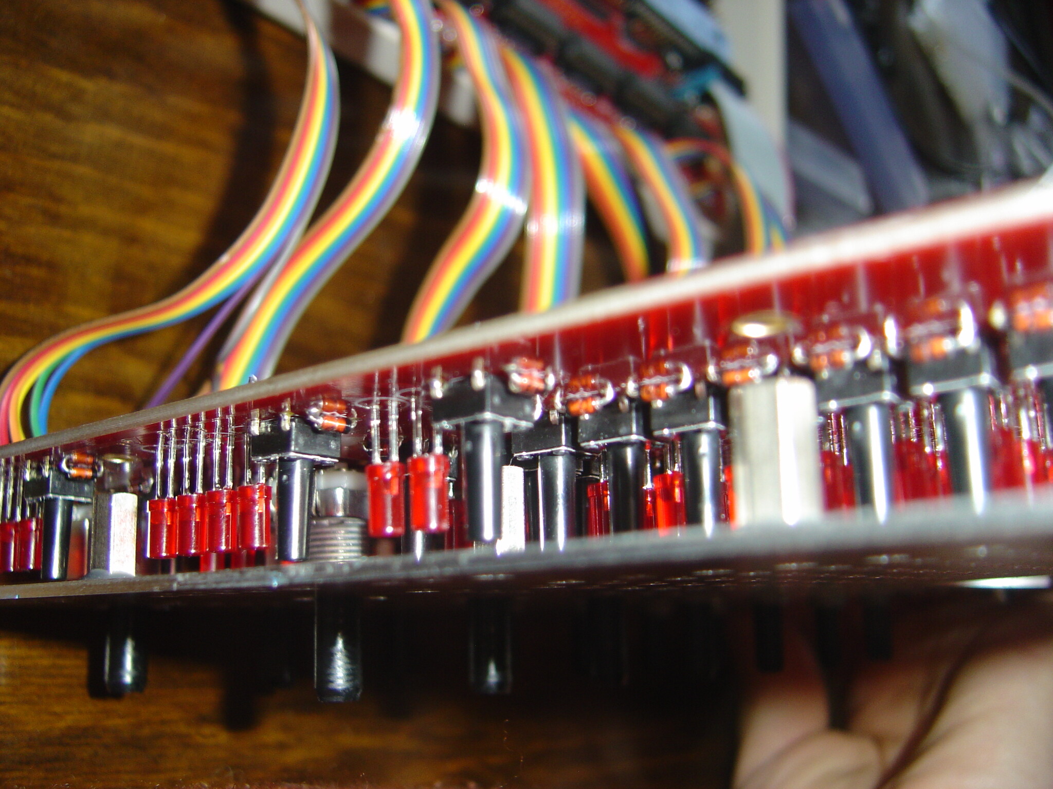

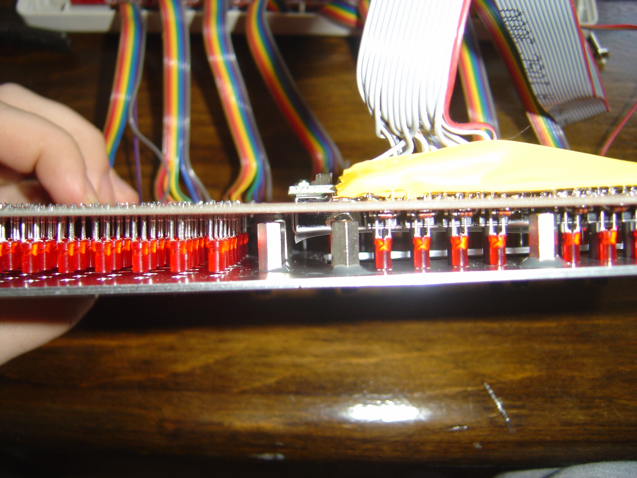

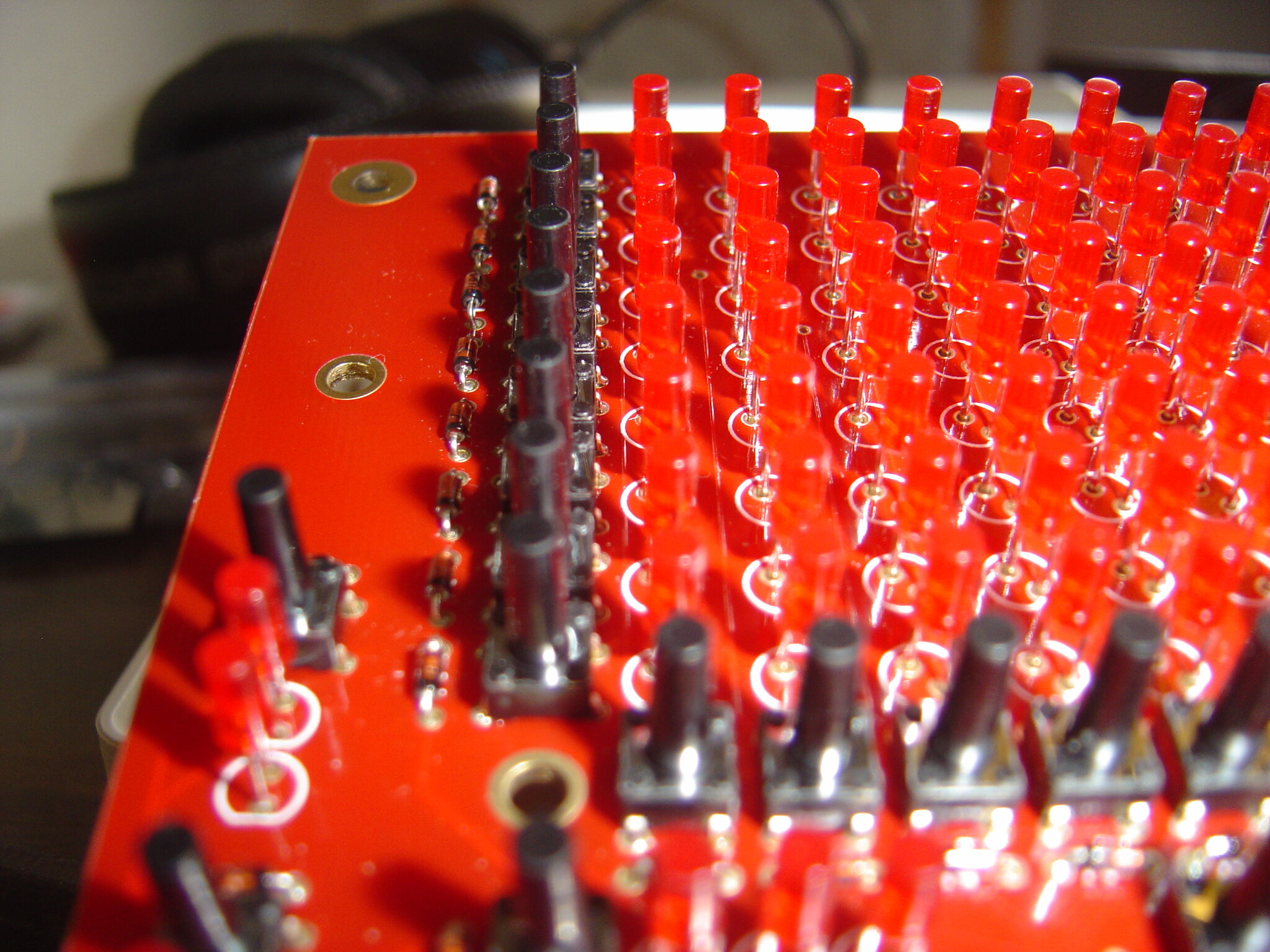

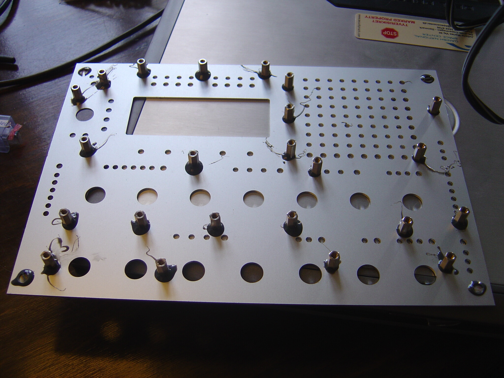

Okay, im almost there with my MB6582 build, and i can’t seem to fit the frotnpanel to my control PCB. I ordered it from Schaeffer and i used the suggested layout file. I fitted the LED’s first to the control PCB without problems. It all fitted! Then i fitted the small switches (and the pots but they don’t seem to be a problem) and i can’t seem to fit the front panel and the PCB because of the switches… Argh!
I’ve read the very nice CS construction Photo guide, and i’ve been through Wilbas CS guide. Does anybody have any good ideas how to make the small switches fit? How to get them inside the holes in the front panel. Im so close! Please help…

I’m not quite sure I understand the problem… is the holes too small, or are the buttons not alligned properly? The obvious would be to drill larger holes if they are too small, or see if there is some way you could reallign the buttons…?
This is rather impossible to give a good answer to without holding it in my hands myself or seing a picture of it…
Maybe they cut the frontpanel wrong? U never know…
But if the frontpanel doesn’t fit, it doesn’t fit, and you need to work on it - drill bigger holes, make sure everything allign up perfectly as it should be etc…
Maybe you soldered the buttons with the wrong orientation (rotated by 90° - thats hard to do, but not impossible ;))

did you use the suggested tactile switches with a head diameter of 3.0 mm?
did you solder them one by one checking alignment every time, as suggested in the tut?
if one is not inserted fully (need to apply quite some force) it may be the case, that it is not 90° perpendicular to the pcb and the button cap therefore blocks somewhere.
PS: if the holes are too small for any reason it is easy to redrill them to larger holes or complain @fpe

For me the CS gave some serious headache too. The reason was that when I glued the 10mm thread hexes one near the filter resonance encoder was 1/2 mm too much in the right. I after filing it for more than enough everything fitted perfectly.
I think that that hex spacer is not that important - JBWeld was just too tight to remove it :smiley:

If you follow the Hawkeye phototutorial this is easy problem to face, as you get yourself in such a “almost there” mood after all the leds etc - then after you solder encoders you don’t test it until you try to fit the cs into the case. Then it is easier to slip to alcoholism than get back from “almost there, almost dancing “its finished dance”” -mood, back into the dirt - file in your hand :smiley:
Check the hexes :wink:
(I think I also had the encoder .1 mm from the pcb - I did press it down and cut the hex a bit. So check all the encoders too - some of them are really low tolerance - tight tight tight to the pcb)
Roope
I solder the switches before the LEDs (or at least snap them into the PCB) so you know it will fit after soldering the LEDs… i.e. switches will be aligned with panel holes when you add the spacers to the panel etc. Did you not use the switches during the gluing of spacers?
Sometimes one or more of the switch shafts aren’t perfectly vertical so they will catch on the edge of the panel hole. Unlike round LEDs which due to the round tops will guide themselves into the holes, the switches are flat at top, making it trickier sometimes. When this happens, you might need to use something pointy like a small screwdriver to push the few that are catching into the holes.

Coming now :thumbsup: But it is quite hard to take pictures of the problem. But I tried.

Nooo. Which is where it went wrong i guess. Maby i should unsolder the switches and resolder them one by one while checking alignment (mission impossible?). I just figured it all would fit because the tactile swithes fitted so tight to the PCB. And yes I was grapped by the “almost there” feeling.

I have decided to drill some bigger holes for the tactile switches in the front panel. I’ll let you know how it goes. Thanks!

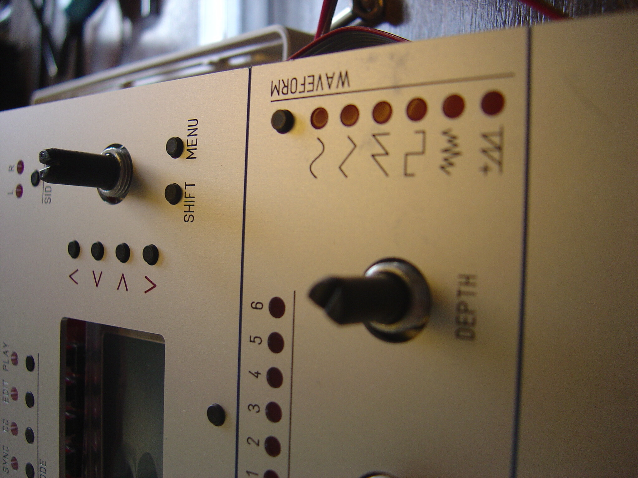

Yeah. I’m quite satisfied with what Schaeffer did with my frontpanel. Im going for the lab test equipment look. :thumbsup:
The front panel and the CS PCB fitted nicely before I soldered the tactile switches. I used the links you posted in your nice guide Hawkeye and i’m quite sure the switches are the right ones. I only used the parts you linked to. But i should have fitted one part at a time and then soldered it… Ufortunately I didn’t. But I will need to think about how to solve this problem best. :logik:

Okay I think that I’ve identified the problem. It seems that 2 of the spacers that I glued to the front panel were limiting some of the movement of the front panel. It needed at tad of free space to one side. The spacers were too close to the pots and I decided to remove them (the 2 spacers). It almost fits now, and I’m confident that I will solve this “challenge” with some patience.
