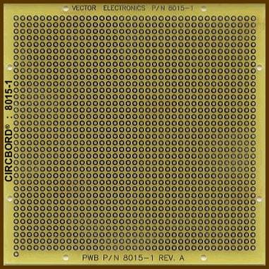

What you’re trying to do here is change the pinout of the LCD pins from the CORE so they match your display.  At the same time you’re trying to connect 2 LCDs to one CORE.  Personally, I’d probably make a little adapter on a piece of prototyping board… like “pad-per-hole” board, like this:
solder down a 3 headers:  1 to connect to your core, and 1 for each LCD.  Then turn the board over and solder some little wires to connect the 3 headers appropriately.  You could then use straight-through ribbon cables with IDC connectors on each end.  This little new board would connect to your CORE and your two LCDs.

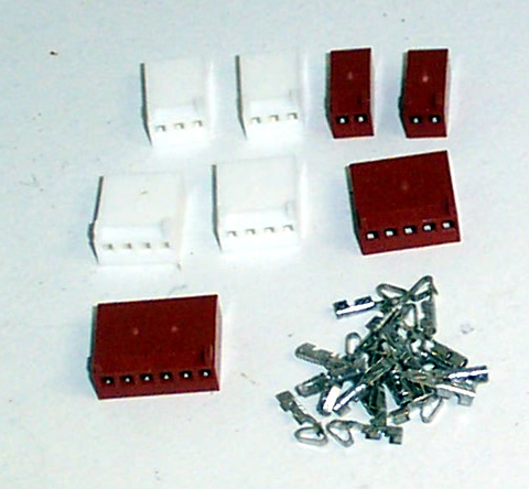

But … that takes up space, and it would be time-consuming.  My interconnect method of choice is the Molex crimp method.  The connectors and pins look like this:
… If you’re careful you can crimp two wires into a pin.  You can use ribbon cable, but I prefer to just run individual strands, similar to the way you typically see the inside of analog synths wired up.
