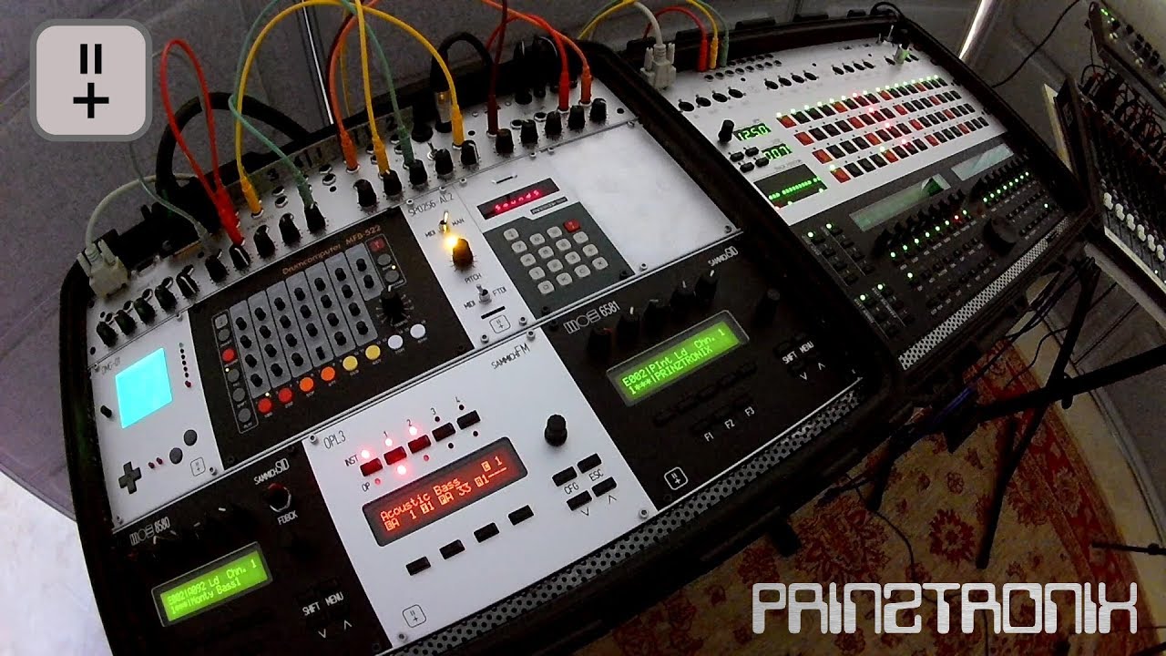

The Tsunami sounds great. I have made a sample player module with his former WAV Trigger. It only has a stereo channel, but I pan the samples and use it as a 2x mono sample player.
Looks like this:
<___base_url___>/?app=core&module=system&controller=embed&url=https%3A%2F%2Fwww.instagram.com%2Fp%2FBcFjrrYA2s2%2F
I’ve reused the keypad and display from an old calculator (like the one to the right), added a micro-controller and a MIDI circuit and the WAV trigger.

Looks like you have been thinking about smaller luggage, too.
Quote
Personally, I only use the mute screen and mute/unmute different tracks, 16 of them are enough for my limited music :slight_smile:
I wouldn’t describe your live jams as limited either
Your "cockpit "and your music is always inspiring
Cheers,  Hal
Thanks, guys! Awesome repurposing of these old VFD calculators, Hal, have you documented somewhere what you did there? Very cool idea!

 Thanks :slight_smile:
It’s actually 8 tiny 7-segment display modules. It’s controlled by an MAX 7221 and an Arduino (ssshh, don’t tell anyone else on the forum) the keypad matrix is scanned by the same “microcontroller”. It’s not documented anywhere no. It has a MIDI In circuit, and the code just pass it on to the WAV trigger. The key presses send Note On and Program Changes.
