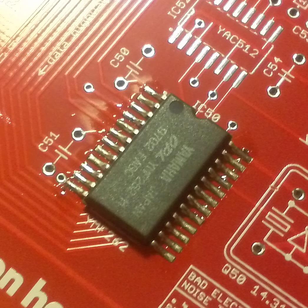

I’ve finally made my first smd following the wilba guide.. after years of stop soldering.. i’m proud ![]()
But how do you clean the no-clean paste flux in excess?

you dont. That’s why its called no clean
Or toothbrush and propanol. Don’t brush the teeth afterwards, you might destroy your gum.
Same as Kristal, isopropyl alcohol is the way to go.
Once I buy “special” flux cleaner, just melt the pcb varnish ![]()
best
Zam
Altitude you’re right, this seems like a nonsense, but when i use no-clean flux some time mixes with the solder fux that results in a little dirt around the pieces.
I’ll try with isopropyl alcohol, thankyou all.
