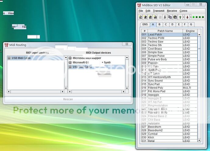

Thanks. Do I need to do any setup on the sammichSID before I do the transmit? I don’t know if my midi interface is muti-client capable or not. It is not a sound card. It is those USB <-> Midi convertor cable with a build-in device. I’ve load the preset sound patch into “Midibox SID Editor” and then I choose “Transmit patch to memory” and it pops out saying that the MidiBox SID not responding and ask me to check the connection. I am pretty sure my midi in and out is working, because I am able to use MIOS Studio to upload the firmware.
Problem fixed. Need to use MidiTrix and Midi Yoke before I start the Midi SID editor. Thanks

When i try to transmit a bank, i get the error message vintagestar posted a screencap of, “The MBSID V2 is not responding. Please check all connections”. Midi Routing is correct and I test MIDI in and out successfully in MIOS, so I assume my connections are ok (I am using MIDI to USB).
