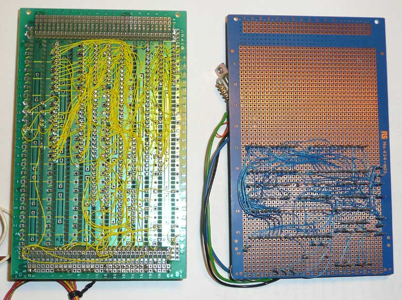

The left hand pic is a text-to-speech unit based on the GI SP0256 chip set. This one is a fully loaded version with serial and parallel inputs, buffer RAM and a few other options. I need to make a cable for the PC ans see if it still works. Might be fun through a vocoder. Made with Vero ‘Speedwire’, (a brilliant though quite expensive prototyping system).
The right hand one is a test board for a Zilog Z* Tiny BASIC system. It’s got a whole 8K of RAM The missing chip is a MAX232, I took out to use in a repair and forgot to replace. The EPROM holds the restart vector. It still works, I think, though it’s a bit short on decoupling caps, because I used to use the special wire wrap 100n’s, and had run out.  The big silver caps are solid tantalum electrolytics - overkill for this job, but were free from the scrap box at the time. It’s done with wire wrap, a technique I still use. The tools and wire can be found quite cheaply on ebay, and you can work up a reasonable speed it you get into it.

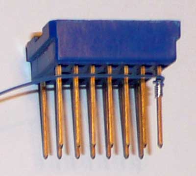

Sorry - but I have to take issue with this one. Wire wrap was originally part of an initiative by the US navy in the late 40’s to try and improve electronic reliability. Two things came out of the research, crimp on terminals and wire wrap.
Wire wrap done properly stretches the plated wire around the square corners of the terminal pin, creating small cold welds. That’s 24 small welds on a 6 wrap joint, (smoking joke may be inserted here). The modified wrap with the extra 3 turns of insulation around the pin is described as a vibration resistant gas-tight joint. In the days of big-iron mainframes, most backplanes were wire wrapped. Telephone companies routinely still use it in exchanges.

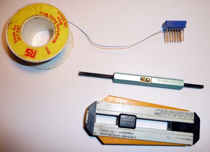

Basic tools are shown here, for manual wrap work.
In answer to Sasha, the wire strippers I use are pictured too. I stopped stripping wire using my teeth when a friend at school got wire jammed between his front teeth and broke one.

Mike, thanks for an answer and pictures. I must admit Ive never seen that tools. I know about and own just 2 types of wire strippers and I dont like any of them.
