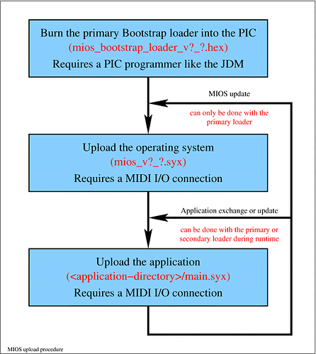

thanks that worked.
so do i have to upload mios before i can upload lc?
thanks that worked.
RTFM…
Best Regards, Thorsten.
RTFM…
