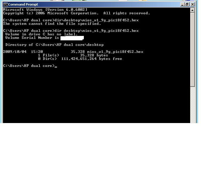

I can get to here
but I don’t understand what I need to do from here on,could someone please guide me through it?

Go to the directory where Perl is installed, lets say its om the root of C: ,from where you are type cd.. <enter> cd.. <enter> then type cd perl <enter>
Should get you into the Perl directory, then run the perl script, helps if the file you are converting is in the same directory.
Its been a while since I did it so may have missed something. Let us know how you got on.
