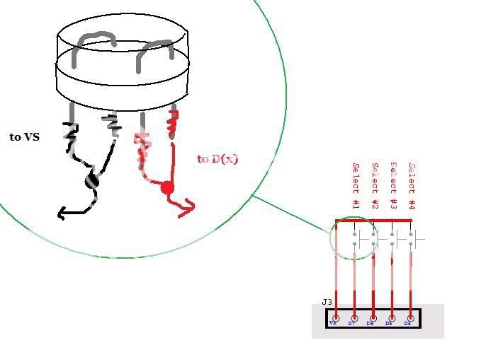

I busted out the voltmeter and there’s definitely some current going through the DIN, but this brings me back to my original assumption: maybe I just don’t know what the hell to do with a button.
My camera’s not working so here’s a pretty ms paint pic.
Right? Wrong? Retard?
I’ve tried all other possible combinations in case my logic, shown in the pic, was wrong.
I’ve tried everything else. I’m at the brink of nothing can be done about it.
right
have you done the srio test?
if that passes, check v at the din pin for each button both when pressed and unpressed
(should be Vdd when unpressed and 0 when pressed)
