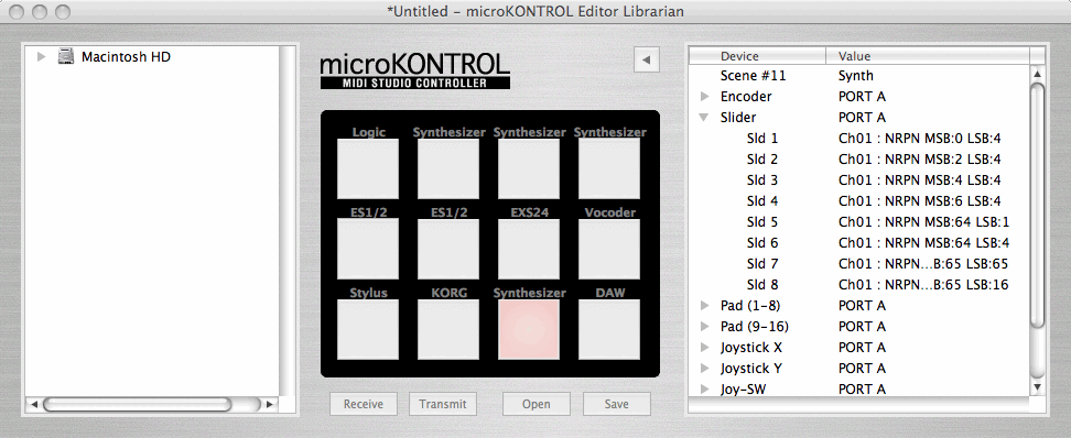

Wrong - you can easily setup the NRPNs for MBSID V2:
Note that the NRPN assignments I’m using here are only intented for testing purposes, e.g. L/R/All channel selection.
All available NRPN parameters are documented under doc/mbsidv2_parameter_chart.txt

.. i also don t like having to ask same question over and over but after reading all possible docs about nrpr, tried all possible combinations on my MK i was not able to use it.
I understand that with 99 and 98 i can choose 1 parameter, ie the filter (yeah the filter!) can be choosen with msb 04 and lsb 00 (for both channels), that means setting cc99 to 4 and cc98 to 0.Therefore i can use cc06 to enter values.
Now in my MK i can assign nrpr to a single fader, but then how can i choose the selected parameter? i don t really understand
tx
simone
The only way is to create different scenes with static assignments. The MK is very unflexible concerning parameter assignments, e.g. in distance to MB64E in patch mode (as an example), you will loose values when switching between the “parameter views” (scenes)
Such an inflexibility is the reason, why people still love Synths with a sophisticated user interface. No MIDI controller can beat this! You will at least miss all the special messages print on the LCD of a MBSID CS
Best Regards, Thorsten.
