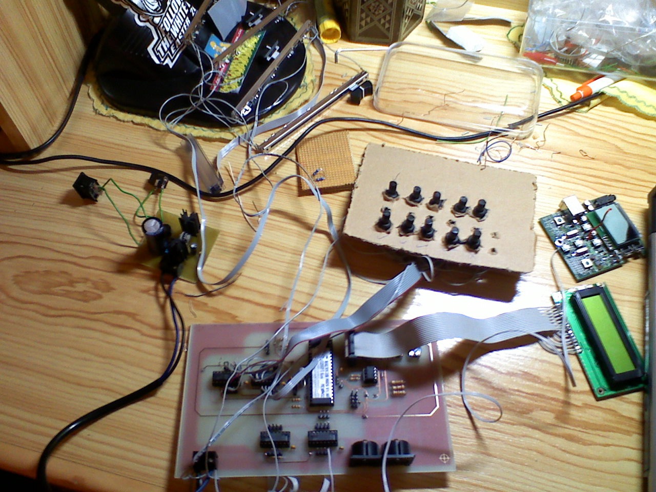

P.S this is my midibox  ;D
Oh, you PCB looks really nice  :smiley: You are aware you’ll now have to answer some question about how you DIY’d it, right?
yeah np about the questions. im constructing this midibox for my final school year project… ;D
