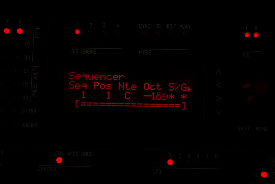

In bassline engine -> sequencer menu, my MB SID RC31 looks like the attached picture. It looks like this when slide is on. Everything else works and looks perfect. Do you have the same glitch? Software or hardware error?

edit by nILS: I attached the pic for you. Offsite doco bad… :wink:
I’ve seen the same thing on mine (can’t recall if it was that *exact* same screen and those exact same characters but I’m pretty sure it was).  So that would suggest it is either an LCD bug or a software issue.  I’m guessing LCD bug since as many bassline demos as TK has done he would surely have noticed and fixed it if it was a software issue. :-)  I have a Crystalfontz display CFAH2004A-YTI-JT.
Its not a bug, its just an undocumented feature.  :wink:
No feature, but a known issue:
http://www.midibox.org/forum/index.php/topic,9457.msg117957.html#msg117957
The bugfix is already in the SVN repository.
