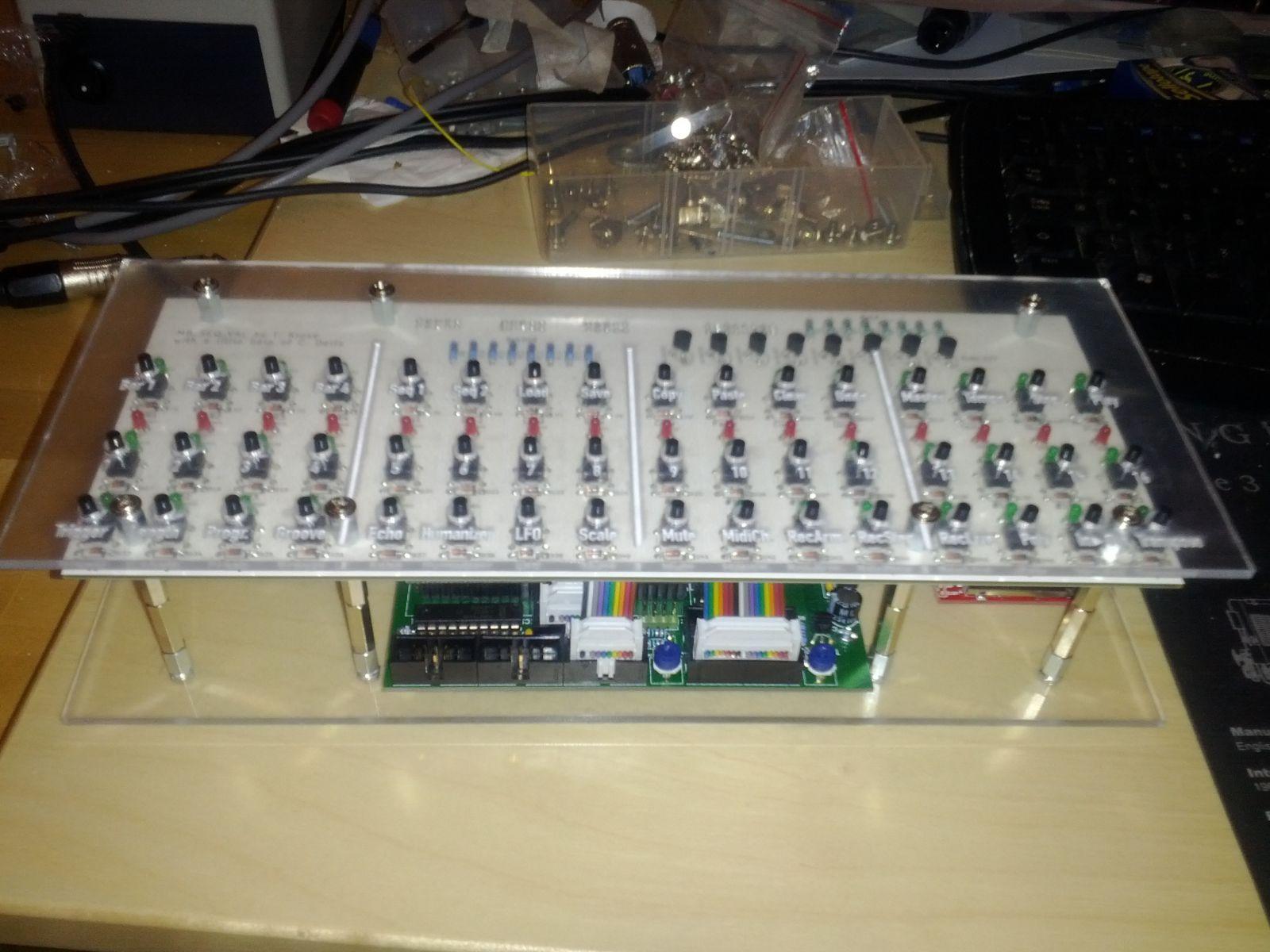

Seq V4L

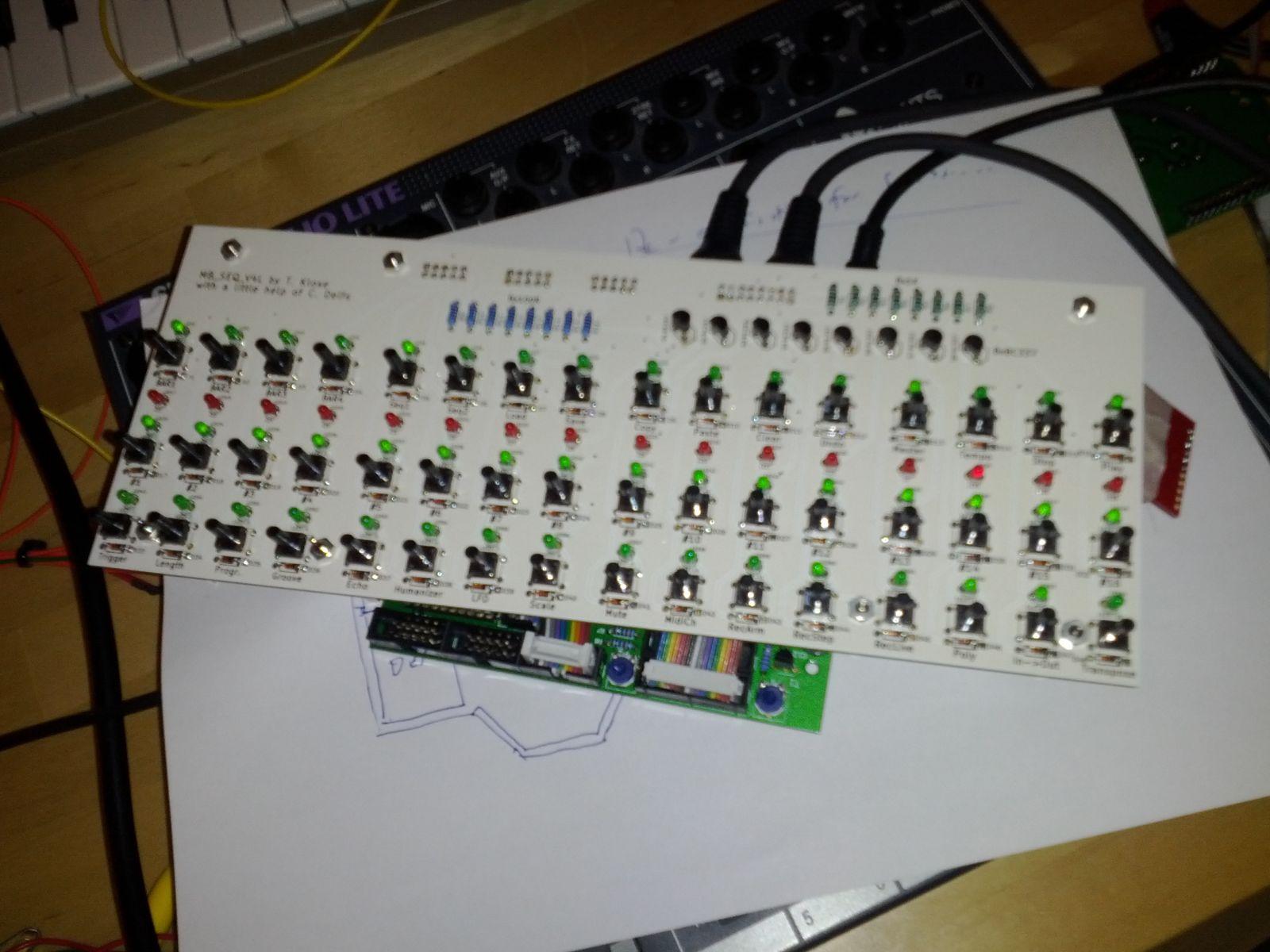

Naked V4L

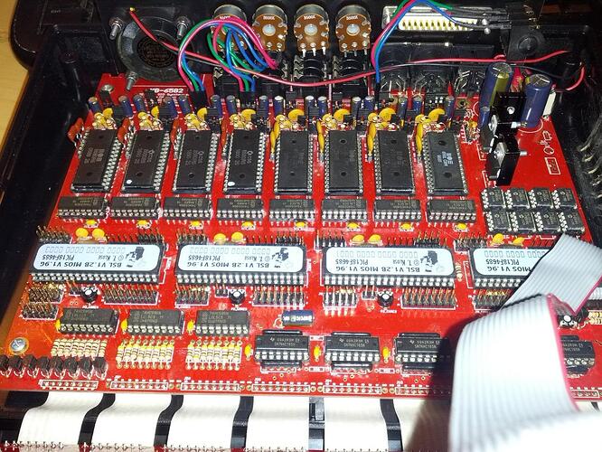

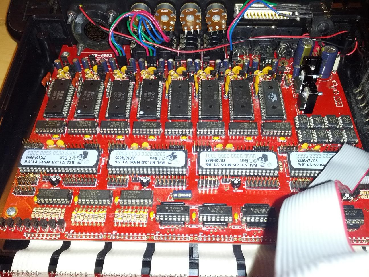

Finally 8 SIDs
The best part of a year after building my MB-6582 and I have finally installed the last of the SIDs. It has 4x 8580s and 4x 6581s. At some point in the future I plan to build a second one and have one all 8580 and the other all 6581.

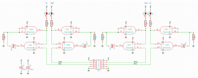

LED Driver
A circuit based on the LTC module, with the sole purpose of providing TX/RX leds.

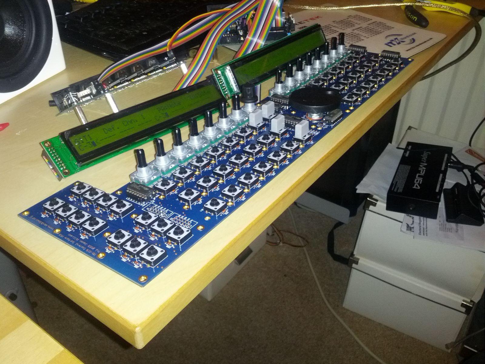

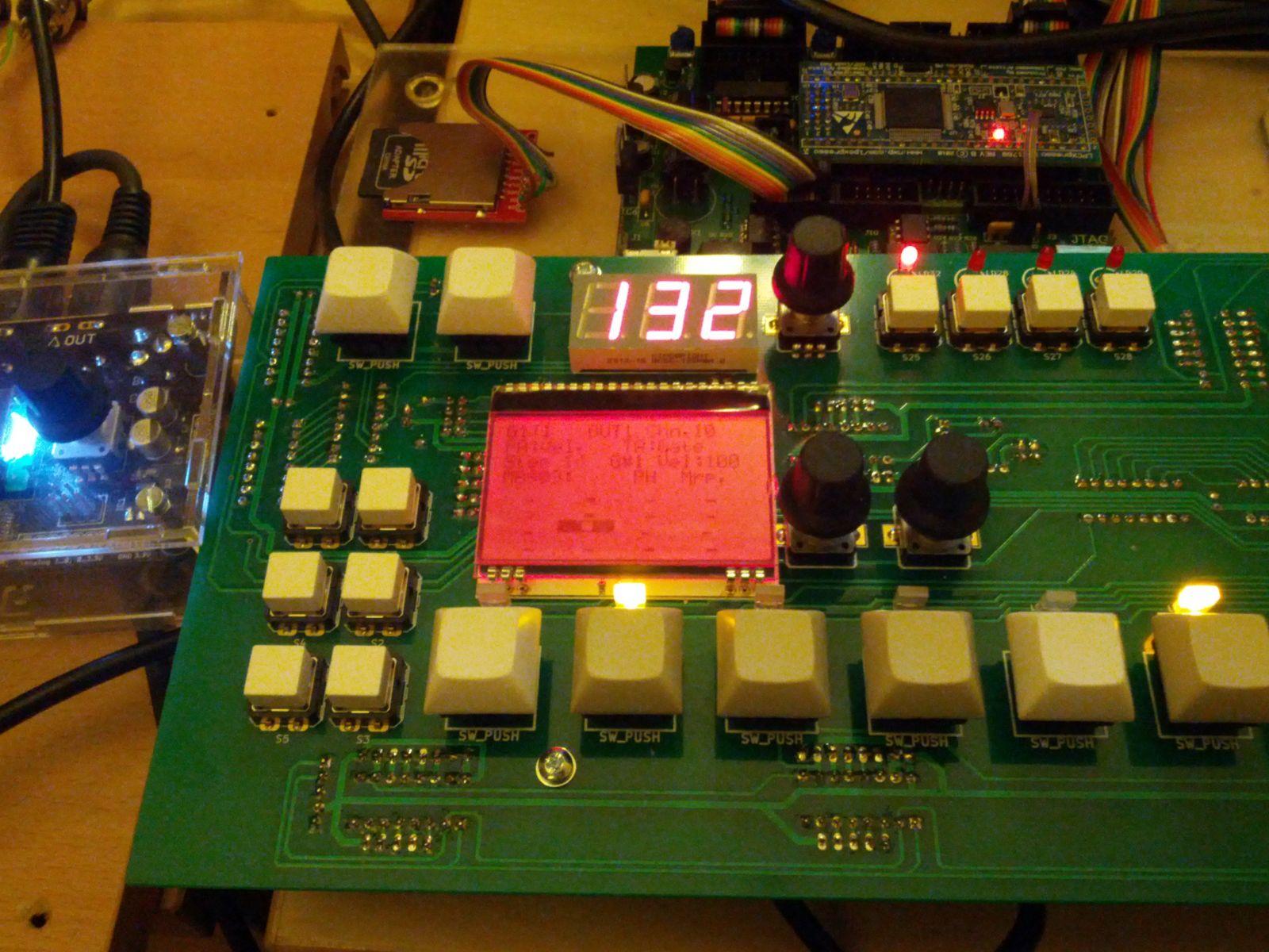

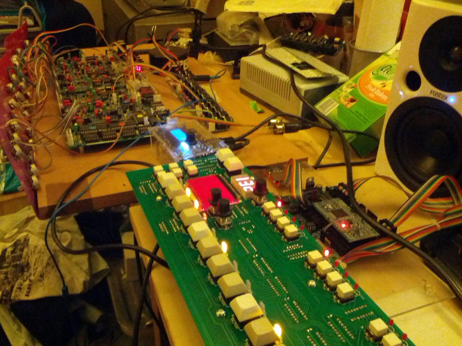

Seq V4
The result of today’s soldering. No LEDs as I haven’t yet got a panel.

Re: Seq V4L
Finished Seq V4L in case.
Re: Seq V4L
yeeeeeppppaaaaa !!!
Re: Seq V4L
I like!
:thumbsup:
Re: Seq V4L
cd_reloaded: Thanks for designing it!
Re: Finally 8 SIDs
Congrats! It is always nice to see a fully populated MB6582 :slight_smile:

Re: LED Driver
This circuit will operate the NAND gates outside of the input voltage range.Each of the 4 gates on the top half of the drawing will be driven with a negative voltage spike each time the LED is turned OFF.How long it lasts will be a matter of chance and luck.
Re: LED Driver
Thanks lylehaze. I need to think about this…:frantics:
Re: Seq V4
Looks promising /public/style_emoticons/default/thumbsup.png" alt=“thumbsup.png”> You’ll have tons of fun building and using this I hope.
Re: Finally 8 SIDs
If the 6582 had it’s own hash tag it would be #awesomebox /public/style_emoticons/default/sorcerer.png" alt=“sorcerer.png”>
Re: Seq V4
Sexy :smile:
Re: Seq V4
waiting for your live performances . looks great !
Re: Seq V4
Nice one :smiley:
Re: Seq V4
Thanks guys!
Re: Finally 8 SIDs
Jojjelito: I agree. Thinking about building a second one now so that I can have one MB-6582(well 8580) and one filthy MB-6581.
Re: Seq V4
is the circuit board from smash-tv?
Re: Seq V4
It is indeed.
