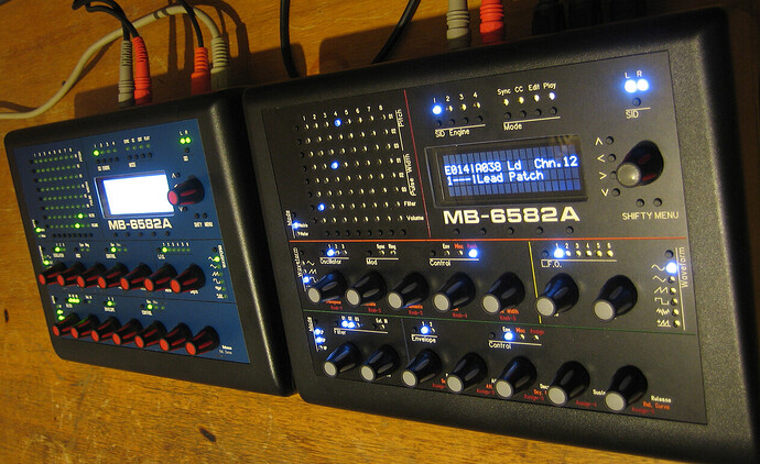

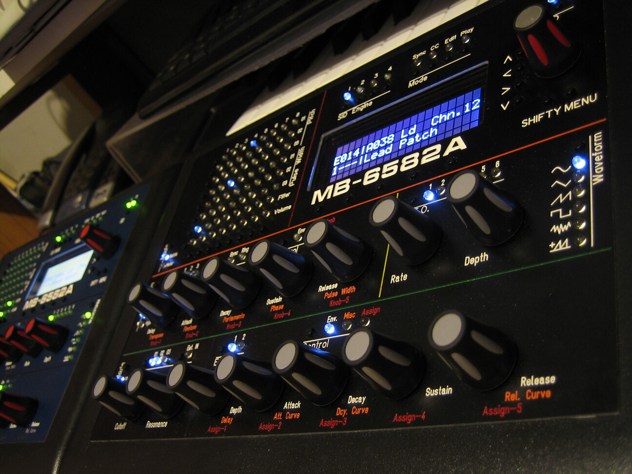

ONLY MAJOR ISSUE, the second CS PCB had permanently switched on/non-working LEDs which reveld itself to be a possible broken
track (could not see a break but still no signal getting through). Installing a link to make the connection fixed the problem.
OUTSTANDING ISSUE, First box worked fine (for quite some time) with a cheap LCD from ebay. But this was always temporary as
ordered black+ white optrex screens. Which also worked fine, for about 10 hours (use), at which point the LCD screen freezes
while moving an encoder. Note: Synth still completely functional - all encoders and switches still function (Its possible to
save a patch if you can navigate there from memory). Over the next couple of days this problem reoccures with increasing
freqeuncy, but still quite randomly. Anything from a few hours to every 5 minutes, but always while moving an encoder.
Tried test screen again (for a day) and operated without issue - major difference between LCD screens was cable length,
20 cm vs 45 cm (extra length allows ‘neat’ cabling) Cut 15 cm out of length (now 30cm). Worked for about 10 hours again and
repeat freeze problem (but only once a day).
At this point encoder chassis has not been soldered, and encoder shafts are a little wobbly cos I found it difficult to reclamp
after removing dents. So, finished soldering encoders + reflowed any dodgy looking joints (inc. all CS Main PCB cabling).
JB-Weld used to secure encoder casing (no wobble anymore!) After about a week it froze just once and not since (about three weeks).
The second box has been completed and repeated almost exactly the same pattern (with another optrex screen). First 12 hours of use
  • no probs then freezing begins, lasts anything from 5 mins to 5 hours, but always freezes while an encoder is in use.
Have swapped cabling between boxes/LCD screens (second box had 45cm cable)
First box (now 45cm cabling) continues to to freeze (1/2 hr -12+ hrs)
Second box (now 30cm cabling) has frozen but very rarely
Next step will be cutting the cabling as short as possible?
ANY THOUGHTS WELCOME

In my complete paranoia about sound quality and LED brightness (and knowing very little)large areas of the first main and cs boards
have machine pin sockets (all components on audio input/ouput lines, all LEDs inc. resistors + transistors, LCD resistor R4, and of
course all ICs).
While much of this turned out to be unnessary i’m still glad i did it. Tried ‘hand’ matching parts on audio lines vs randomly picked
and theres very little if any diffence between audio signals.
My main concern was getting a ‘mono’ sound from a stereo signal ( i.e. two independant sound generators) , this was not an issue. I’m
only guessing but I think wilbas 6582A SIDs are the key to this (16 chips and they all sound virtually identical) using different
revison SIDs and/or filter caps might change this???

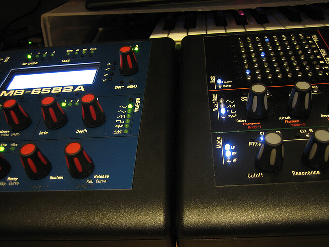

Also I had my mind set on using white LEDs (originally with a white case, changed to black)
and cheapest I could find were clear 1500-2000 mcd, at $0.81 AU, next best were low level diffused but price was more than $3 each!
(112 + spares = far to much to spend on an ‘experiment’ so I got 200 with the aim of using remainder as tests for diffusing/ colouring.
and socketing all LEDs just in case I really don’t like it (even though this mean I have to cut LED legs exactly to size for equal height,
this is still an on going process!). However, after some testing I found 10K resistors reduced the bightness level to a acceptable level
(very simialr to LCD levels) but… two noticibly different brightness levels appered (not much but enough to make the Mod Matrix appear
to have ‘spotty / blotchy’ with all lights on). This turns out to be specific to the LEDs (theres NO difference if run at correct voltages
i.e. blinding!). So rearranging the LEDs, ‘softer’ LEDs used in Matrix and ‘brighter’ LEDs used elsewhere, solved this issue (hooray for
socket city - but i still wouldn’t recomend it).

Welcome aboard Q.C.! :flowers:
Another proof that the midibox concept is working - you got from 0 to 2 mb6582s w/o a single post, congrats!
About the LCD issue: It’s freezing after a while and not instantly so possible problem sources might be heat (unlikely but possible) there’s also been problems with some of the C64 PSUs so that might be worth looking into.
Congratulations on finishing two… and they look awesome. I really like your customizations on both the panels… it reminds me of d2k’s MB-SID which was the original inspiration for my MB-6582 panel design:
LCD freezing: this might be similar to the freezing that fussylizard noticed on the Optrex STEP 2x40 LCD… that if R12 was used, it might cause the display to be unreliable. I’ve also noticed occasional weirdness with an Optrex STEP 2x20 LCD connected to a sammichSID which was working perfectly with other LCDs. I’m still not sure if it’s R12 that causes the problem or incorrect/insufficient backlight power supply.
If you want to try taking out R12 on the MB-6582 base PCB, it’s labelled R12_CORE1 and it’s under the PIC, inside the IC socket. It should be totally safe to remove, the LCD and Banksticks should still work.. it’s easier to cut it in half and desolder each half separately than take it out whole.
I once had a problem with a freezing LCD which was similar to yours.
It seems some displays don’t like beeing talked to in 4bit, even if the datasheet says it’s ok.
I don’t know if it is possible with the MB-6582 Pcb, but I wired my Lcd for 8bit, and my problem was gone.
I also remember changing something in the Pic-header to enable 8bit, but i can’t recall what it was exactly.
