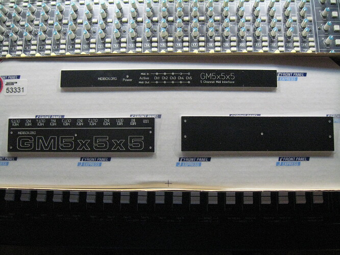

Yes, the long piece bends 90 deg at the small tick marks along the bottom edge. this piece wraps around the PCB. The top and bottom (the two smaller pieces) go above and below. The whole thing assembles with some M3 x 35mm cap screws and a few spacers like a sandwich. The side with all of the i/o connectors is left open. Should make a small, smart looking package that will fit in the palm of your hand.
Cheers,
gtxdude

gtxdude’s small design looks awesome too, it’s a nice approach. what did it cost to have it made?
it looks in fact so good that i’m thinking of getting one like that.
That’s the problem with one-off projects like this, the metal is stupid expensive: $130 USD. But if you want something that looks good, you gotta spend the bucks.
For such small cases you could always replace the metal with acrylic panels and have them lasered at Ponoko.
i guess the reason for the price is the extensive cutting. it looks good that way, but every individual MIDI labeling adds to the cost.
maybe if you reduced the writing to just I1 O1 I2 O2 you could have saved a lot of money, but, man, it looks good :slight_smile:

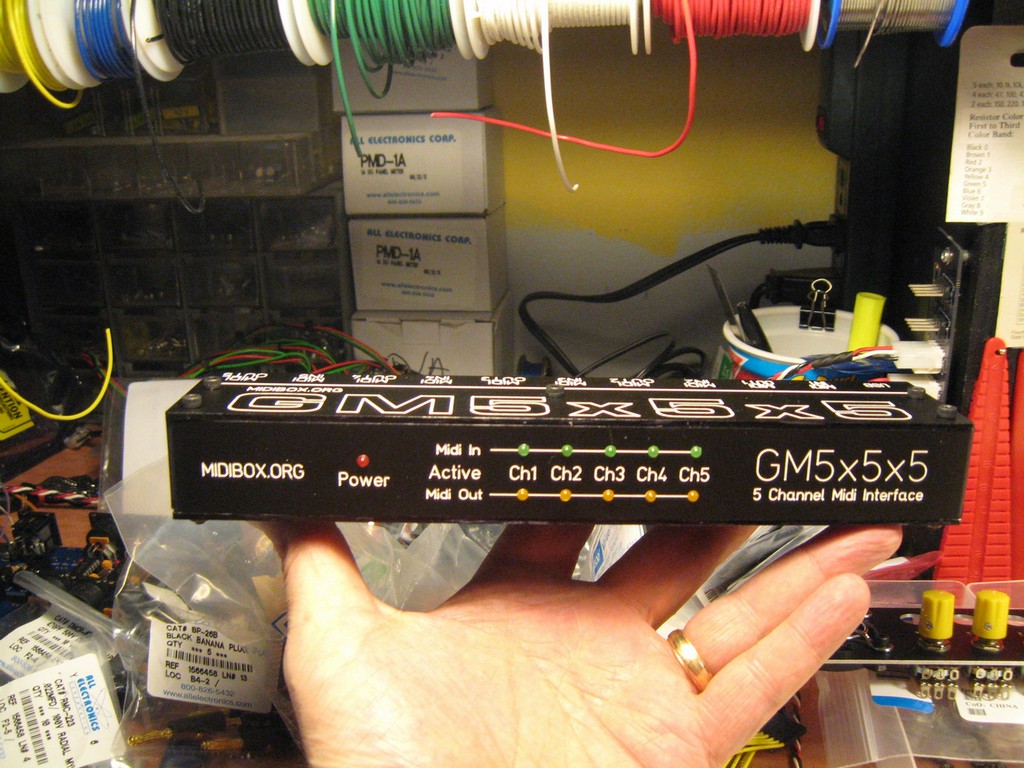

Got the metal today for my little hand-held enclosure. Man it looks great! I will most likely have time to assemble it this weekend and I’ll update with a few pics when it is done.
Carry on,
gtxdude
Finely got the mini 5x5x5 enclosure built. I’m very pleased with the result.
Cheers!
Gtx
Nice.
Well done ! Looks really ‘‘pro’’ :flowers:
