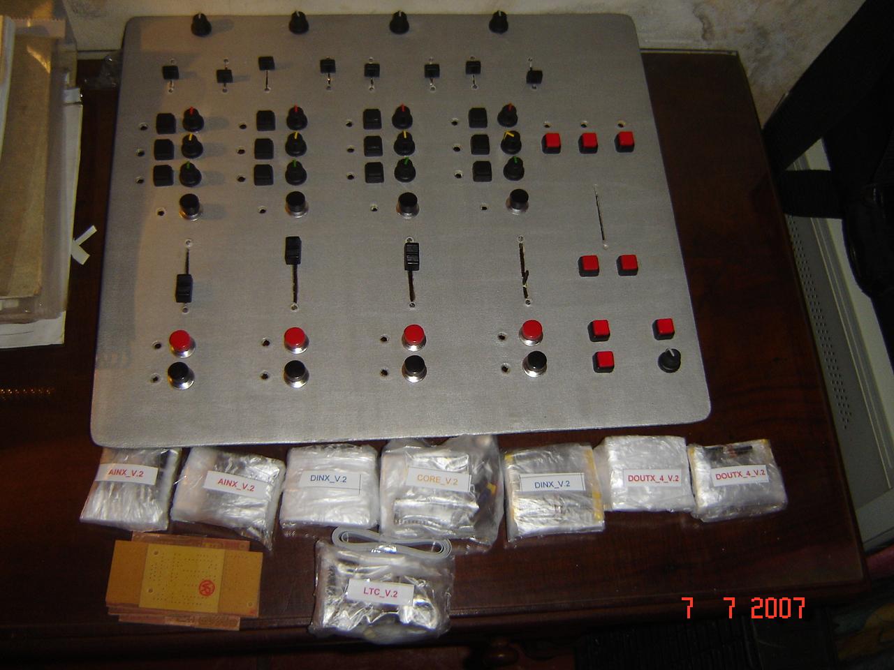

Well…I create this topic to show all midiboxers my almost finished midibox to control Ableton LIVE. (I think this might be the second or first MB from argentina lol)
Up to now i have used 32 pots 32 buttons and 32 leds for basic  live´s channel control and launching clips; on the second stage i will use the 32 buttons and pots left to control effects on the return channel and replacing the mixer front panel from one made of aluminium.
I hope you all give your opinions, thank you very much.

yes we can see it..  havent you assembled all the units yet?
what s the panel made of right now?

Well the panel is made of wood, so i plan to make it of aluminium. The biggest problem i had when planing to do it in alluminium was how to make the slide pots holes, so practical solution was wood.
Can any of you tell me how to do the holes for the slide pots??
BTW: Any comments about the front panel?

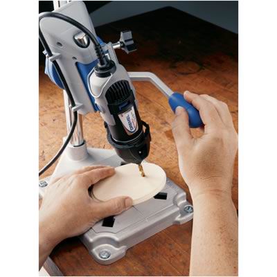

Hey David do you think this press for dremel will work?
IIRC those are called a “milling table” … I was looking at them myself but they don’t come cheap and are generally too small to do a whole panel… Should be perfect for one or two fader slots though.
I’ve got a drill press like that for my dremmel, it’s magic for doing holes, but I don’t think you’ll get great slots like that.

I think I have found a good solution for the slot with dremel what about this kind of press?  :smiley: :smiley:

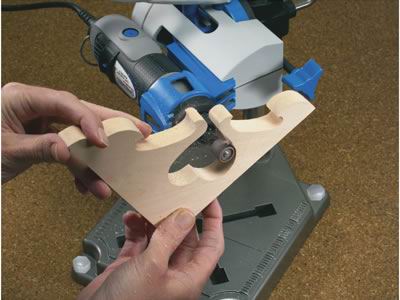

Or maybe this one (I think this one can be the most reliable option from my point of view)

i think that the tool with a round somethingwhatsoever piece of plactic arount the bit is the best choice, you need to know the distance between the edge of the round somethingwhatsoever and the center of the drill, f++k
enga man en espanol a ver si me sale mejor, la herramienta que mejor te va a servir es la mas sencilla, la que es nada mas que una rueda de plastico que se pone al rededor del taladro.Suponiendo que sepas el diametro de esa rueda, no tienes nada mas que hacer un hueco para empezar el corte, poner algo que te guie a mitad de la medida del diametro (se llamarao verdad?), paralelamente a la linea del fader, inspirar bien y adelante, mucha suerte
