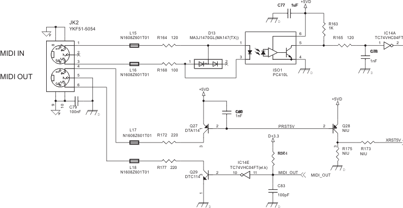

I actually managed to get a copy of the the schematics of the actual AX Synth MIDI circuits:
There seems to be a bit of extra stuff in there before the actual output circuit as I know it from the MIDI spec. Could it be that Q27 and Q29 are used to reduce power consumption when the AX goes into power saving mode? It does that automatically after x minutes to save batteries.
Anyway, would it be possible to take the signal from IC14E and put that directly into the Widi-X8 UART? I think IC14E uses 3.3V logic instead of 5V so I’ll have to check what the Widi-X8 input (post opto-isolator) can accept.

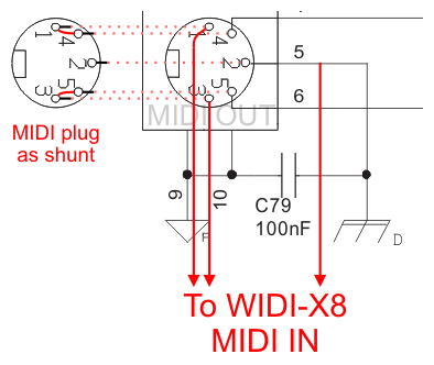

I just had an epihany. Instead of drilling holes and installing an actual switch, I could use the unused pins 1 and 3 of the AX Synth’s MIDI OUT along with a DIN plug acting as a shunt to create a switch:
The beauty of this arrangement is that since the MIDI plug inserted into the AX Synth’s MIDI OUT is the actual switch there is no possibility of the switch being in the wrong position: as soon as you remove the shunting plug from the MIDI OUT it becomes a fully functional MIDI OUT port again.
Just in case someone Googles this thread, my idea above doesn’t work because in their infinite wisdom Roland have decided and managed to source a MIDI chassis part which does have 5 holes but only 3 of them have any metal in them. I didn’t know such a thing even existed. The manufacturer’s part number is YKF1-5054. Damn you Roland :frantics:
