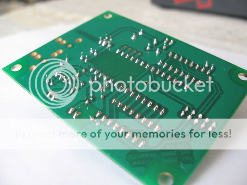

The dout was my first solder except for a a simple 3 channel mixer and an Atari punk console (which was a pain to solder..) which I bought mostly for soldertraing. I´d love some feedback on the soldering. I know some is more like a ball then cone (to much solder or to much corrosion?) and some has to little solder and don´t fill out the solderpad. But how bad is it?
This is the dout in all it´s glory
It looks very good for the most part but with a few exceptions; some of the more “blob” looking joints (as opposed to “teepee” shaped) could indicate a cold solder joint.  Likely the component lead was hot enough but the PCB pad was not.
In fact I can see some of the IC leads where the pad is not fully covered in solder.  If the pad is hot enough solder should flow into the hole and across the entire pad.  Sometimes just reapplying heat (making good contact with the pad) will be enough to get the solder to flow.
Other than that good work…I don’t see any char marks or lifted pads so you’ve done better than many noobs :slight_smile:

thanks for feedback! I think you are right about some of the pads didn´t get hot enough. I tried to be fast due to my fear of adding too much heat and probably ended up with too cold pads. Soldered a Din today when the children slept and tried to apply some more heat to the pads. I think I did better but still one or two “round ones”. Smash Tv is the greatest btw! Had my laptop next to me and just followed the info for the module on his site. Makes it so much easier for a newbie :slight_smile:

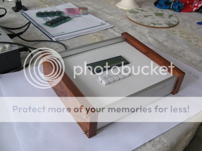

Here´s also a pic of the case I´ll probably use. 2x20 LCD and 10x10mm switches with green leds in them Don´t know how to hook the switchleds up though so any suggestions are very welcome! Been thinking of connecting them to “power on” so all 10 lights up when it´s on (yes one will only be for looks ;)) Or maybe some random light from a dout? I don´t really know what´s possible here…but I liked the looks and feel of them.
case looks nice jooks, i realy like the endcheeks.
Hey you might like to use the width setting in your img tags (Search for it), or better yet, attach them to the post, rather than hosting offsite.
Jooks, congratulations on a build. Beautiful wooden sides. :slight_smile: I also like those screws. But I don`t like much how top panel is lowered. What was the reason you mount it that way?
Hmm yeh I didn’t notice that inset panel. That reminds me of some mil gear, where the faceplate is inset to the same depth as the switches… Idea being, if you drop it on it’s face, you don’t touch any controls… Not sure if that was the intention though.
BTW, are the ply endcheeks stained or?
The endcheeks are solid but I don´t know what kind (old wood from the 60´s ;)) The inset panel is because this is the existing mount for the watch so really easy to just slide in a new panel there. I might mount it on top of the alu in the end though, haven´t decided yet. My playing isn´t really that wild that I need to protect the controls this way :smiley:

Heheh, after stryds reply I started to imagine you as a cyberpunk jumping with that SID all over the place so that panel seams as a good solution.  :stuck_out_tongue:

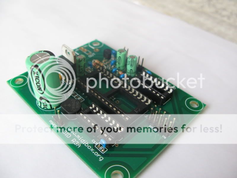

Almost finished the Sid module yesterday (actually took a shower also but a very short one). Can I just solder the extra cap suggested at J2 vs-vd in the c64 optimized psu directly to the solder pads or pins or? (as mentioned I a super newbie, tried to search for an answer/pic but hasn´t found any clear enough for me to understand…)
Sid module finished except for the C1, C2 caps which I will use machine sockets for (so I can change filtering). I feel more and more confident soldering but I don´t think it´s that much improved. I imagine it´s a bit like plaing golf. It´s easy to hit the ball perfect once but to do it hundred times in a row is really difficult!

Looking good… Still a few solder blobs that I would be tempted to reapply heat to though  :slight_smile:

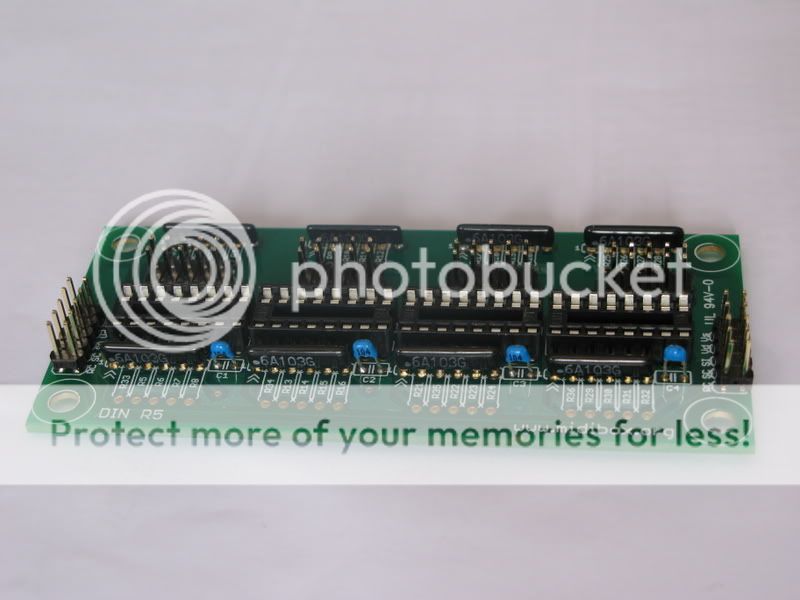

Yep, I think I´ll have to take a close look at all modules and try to fix up bad joints before I add power :slight_smile:

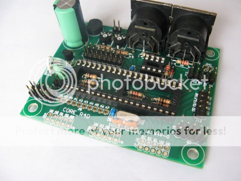

Finished the core yesterday. Unfortunatly the midi I/O were not my best joints so far. It was hard to hold them still and in place and I sat in halfdark talking to my wife at the same time but I think I know how to do it better next time anyway…

If you have a temperature controlled iron, turn it up a touch, and go a bit faster. You’ll avoid those cold-ish joints. (they’re not that bad anyway)
I know they’re not that bad, I was just being picky :slight_smile:
