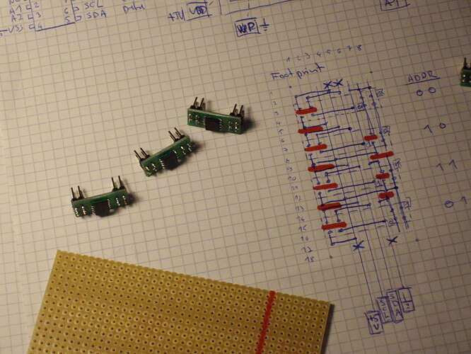

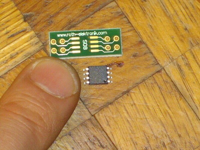

I just received the IC’s and built a PCB with 4 of them, I used some “SMD wrappers” to mount the IC’s (This rellay costs nerves if you don’t have flux on hand, I’ve got to learn design/etch PCBs!)
Next step is to write a driver in ASM for these, this will cost me some more nerves because this is my first ASM project  :slight_smile:
Enjoy the pictures
