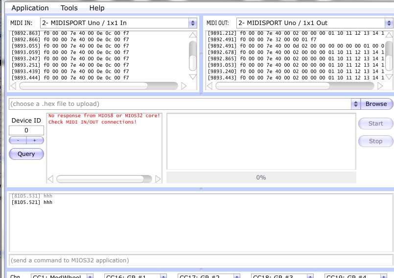

Fixed- sammich - mios cant query device f0 f0 f0
My device is getting weird extra data in mios.
The device loads mios and says ready.
extra f0 f0 f0 before ID
Research in mios guide and this forum post said maybe bad filter cap so I replaced the 2200uf cap, maybe thats not the one, anyway still error.

Yo, So it works without the top panel I can query it!!
maybe the power from the lcd is droping it

Now I am getting extra data at the end of the messages. -EDIT NO its normal I was wrong
Can not query device anymore. I have sid’s on and without top panel still no go. Seems like it turns on fine and I can go through the menus. Could not upload patch to test sound.
So I do not know what to do about this power problem or maybe its a midi out issue.
