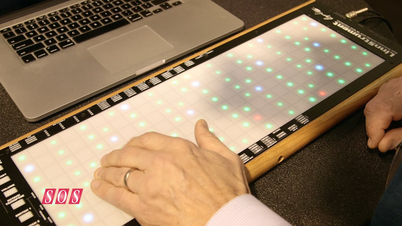

With the isomorphic keyboard, it seems quite similar to the Linnstrument
I had totally forgotten about the Linnstrument - looks like it does do a harmonic table layout if it’s set up that way. It was the C-Thru Axis controllers that got me thinking about harmonic tables again, and those used hexagonal keys, but it might make more sense to either do another BLM grid, or implement the harmonic table layout on the existing BLM, instead. The reason behind the hexagonal keys on the C-Thru, and the staggered button layout, was so the player could easily play a major/minor triad with just one finger - which wouldn’t be nearly as easy to do with the button pads. So if I could get the same functionality out of the existing BLM, it would free up that space on the control surface for other stuff.
well then build the BLM first, and then Touch/feel the buttons, what do the feel for you
… for me it dont have the feel/touch to play melodys on it, i mean you have to play precisely o…, and touch it the right way in order to activate the right.. … i am no keyboarder yet, i stell play the last year from time to time, and as techno musican it gets wild… being in beat, hitting in beat -its then
a.  good to have this big white and black keys to hit the right note… (i talk about size not, the arrangement off keys)
b. the feeling the instrument is built for that so you can really punch it… with the BLM i ever have the feeling of “not touching it to much” … i even thougt about it, to exclude my 16 ROLL buttons (which i use most and hard) from the BLM-XY-ExtraBtns and take some more robust one (i havnt found them yet), i have thougt about DIY optical ones with Diodes/fototransistors, and AIN moduels…
