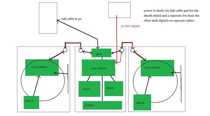

The solution that i am using for my traktor set up is to put a gm5 in the mixer controller, then add two ports on the rear to link the two decks to via thier own cores, using the digital in pins on the gm5.
By doing this everything goes through one usb output, so i link the mixer core to midi i/o pin 1 and the left deck to midi i/o 2 and the right to midi i/o 3.
this makes things easier. the link cable is used with mini din sockets and connectors that are available from ebay very cheap along with the cable.

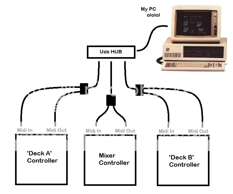

Thank you guys for your replies; however, I got quite confused at certain points (I hope I’m not a nuisance). Let me take a look at them:
The cores you’re looking at is the PIC based ones. They have no USB as such. If you really want your builds to use 3 USB connections, then i think you should take a look at core32 module which has a USB connector.
Is the core32 capable of handling analog inputs (pots)? I find encoders and LED rings harder to set up and configure, as well as the core 32. If not, I think I’m staying with the core8.
And something else… is it possible to connect a core8-based controller (those with no usb port) to a pc using a Midi-to-usb converter (some kind of cable I found on stores and seem to be quite cheap), for both configuration and usage of the controller? - If this is true… I’ve been thinking of the following SOLUTION…
(Power connections were ommited, obviously)
If not, I’ll immediately delete the image due to my excess of ignorance and stupidity.
Because, you see… that gm5x5x5 interface (is it an…?) thing just made my brains explode.

Your drawing is almost the setup ssp described.
The only difference is, that he uses a usb-to-midi interface with multiple ins/outs which is inside the mixer.
This interface is called gm5 and if you build this instead of using the cables+hub, you will avoid lots of trouble.
These cables, and even more expensive interfaces too, they tend to lose data while uploading apps.

ok in the mixer put a core with a 452 running mb64e youre going to want this for the buttons. also ainx4, dinx4 and a dout for lights should you want them also a 16x2 lcd for built in editing of controls etc, also a 512 bankstick built onto a board as a permanent fixture.
in each deck put a core with a 452 running mb64e 16x2 lcd, you dont need an ainx4 just use the headers off the core, you can ground pins you dont use however if you edit the asm file to just the pins you use, then you dont need to ground the unused ones.
now to link the units.
in the main mixer is a gm5 this is a single usb port with a single midi in and midi out physical port, however, the board still has 5 ins and 5 outs including the port 1 that is there.
to link them you leave the 6n138 ic off the core once assembled, then you link from mi/mo (midi in/midi out) from j11 on the core, these goto the gm5 j6 pins.
so as per this.
mixer core to gm5 mi/mo 1 pins
left deck core to gm5 mi/mo 2 pins
right deck core to gm5 mi/mo 3 pins
now the power, if you get a multiway cable then you can use a mini din socket, 5 pin mini din is fine and then you can have the digital mi/mo links and the shielded power feed also over a single cable to each deck. You can get power supplies that deliver upto 2.5 amps and 7-10volts which the cores need as a wall wart, or laptop style power supply which is what i am using.
when you now connect your decks to the mixer, the mixer connects to your pc via a single usb cable, thats it everything data waise from the decks and mixer is sent back and fore via this single usb cable.
you need to use the built in editor to give each unit its own midi id number as well, this will help when setting things up.
when set up the mixer will have the single usb cable and the psu connection to it, then from the mixer to each deck.
its a much more elegant way of doing things, i will do a diagram later today to explain it visually.
basic picture to give you the idea.
