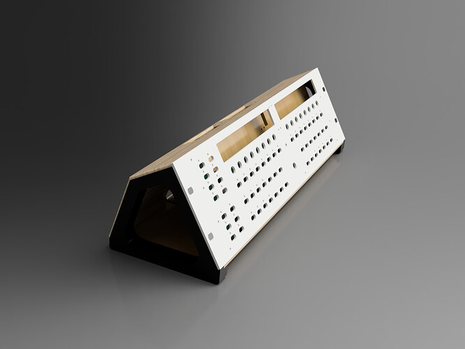

First step was to dig out my CAD model from when I made my panel and start modeling up what I had in mind.  I had to make it a bit deeper than I was hoping to make room for the MIDI boards on top - but I really didn’t want them hidden in the back either so I decided I could live with the compromise.  I printed out the new side supports and cut a piece of MDF for the base.  Already this was a big improvement and the whole thing felt more stable and sturdy!  I added some heat set inserts so I could remove the top and back easily without damaging plastic threads.   I also added some threaded inserts to mount the core and line driver modules.
The power was a bit trickier.  I didn’t want the power cord coming out of a side…but I didn’t want it slanted like the back either.  So I designed and printed a plastic piece to hold a switch/fuse/jack combo - and I’m quite happy with how that worked out.  It’s very easy to find with my fingers reaching around from the front without having to look.  And with it’s own meanwell 5v supply I don’t have to worry about voltage dips.

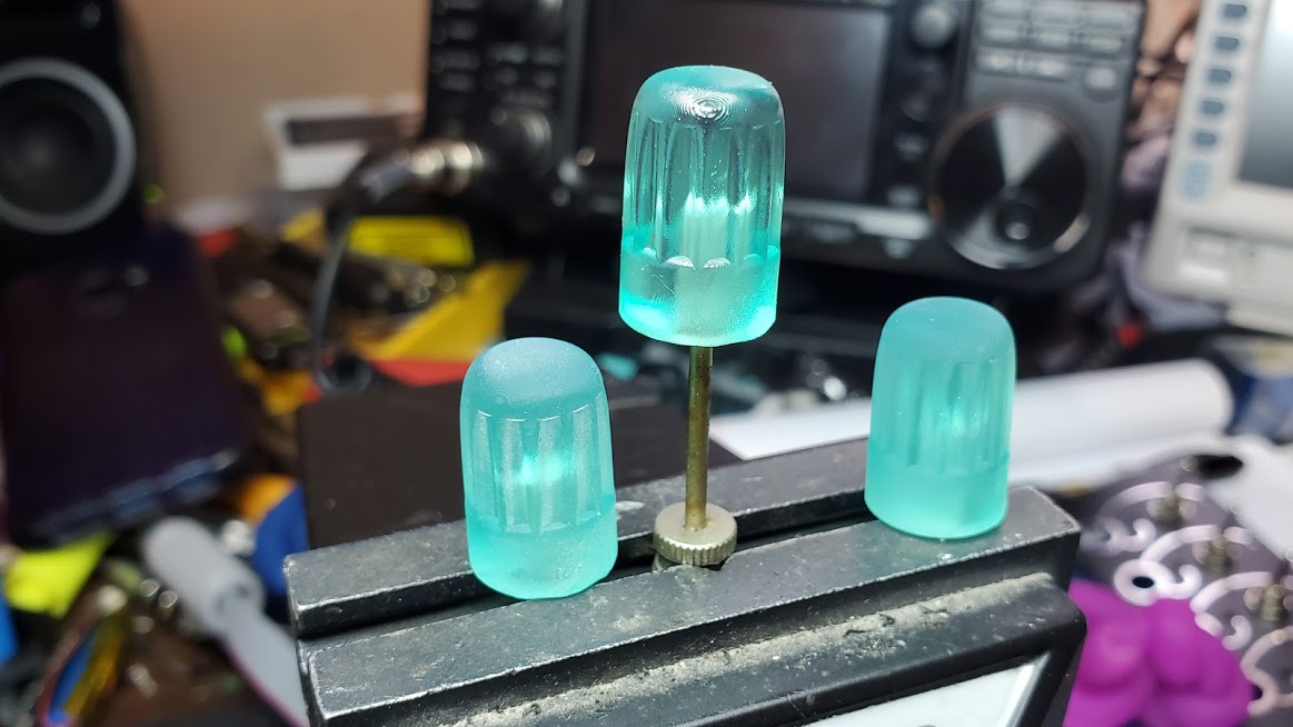

With the sequencer now much more mechanically stable I figured I needed to step up on the caps/knobs.  Earlier in the summer I had invested in a SLA printer since I needed custom concentric knobs for a different project and was unable to find any commercially that I was happy with (at least in quantities that made sense for me!)  So I printed up a new set of caps in translucent resin.  I also designed some new knobs…they’re a bit taller and more tapered than the ones I had made previously and feel a lot better to my fingers.

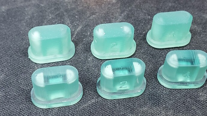

Great job, especially the labelled buttons are a really nice touch! Formlabs printer or something else? I guess the aspect ratio/height is enough to print them vertically rather than rotated?

No Formlabs here, just the “Cheap” MSLA’s - the translucent switches and the grey were done on a Phrozen Sonic mini, and the blue were done on an Elegoo Mars Pro.  They both have almost identical print quality but the phrozen has a more efficient LCD so it can print a little bit faster.  I’ve also found it to be a little more reliable despite the Elegoo feeling like a higher quality machine out of the box.
The caps can print vertically right on the bed, it’s a bit over an hour to print 15 of them that way.  But these were all done tilted 30 degrees in two directions and then supported 5mm off the bed…so they take a bit over 2 hours to do 15.  The tops come out a bit smoother printed this way since X/Y resolution is finer than the Z so the curve of the button top comes out nicer.  It’s a minor difference and really hard to show in the photos (the shot of 6 translucent caps tries to show the difference.  The top row were printed tilted, the bottom row was printed vertical.)
Printing them on supports is a bit slower and means more post processing…but it’s worth it for them to feel nicer under my fingers :smiley:
