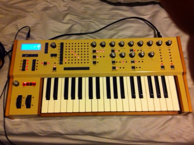

Wooo.
It has taken a fair bit of time just to finish off the timber work… mainly because of becoming a parent etc..
I’m happy with the end result.
Thanks TK , Wilba & all.

Do you have a bigger picture? It’s hard to see everything on the one you posted.
great great work!
are these 5mm LED’s?
i’m going to do the modulation matrix with those e-switch tact switches, instead of 6X6mm ones and i was wondering if the resulting greater distance of the led rows might reduce the perception as one unit. but that doesn’t seem to be the case, judging from your panel.
how big are these switches you used?

Yep.. 5mm LEDs. Nice and roomy.
Those tact switches are 12mm x 12mm
It’s also got an internal SM power supply..
I’ll upload a better pic later.
It is pretty nice … I’d like to see a nice 3/4 view - the offset in height kinda reminds me of the Sequential Multi-Trak/Max line of keyboards. I really like that low-profile design, and I don’t think the pic is doing it justice!

Do you use midi merger for midi input and keyboard???

Yea, I used a merge to merge input from the outside world & internal keyboard.
