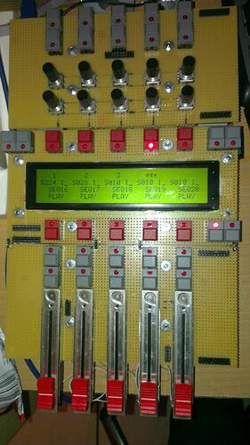

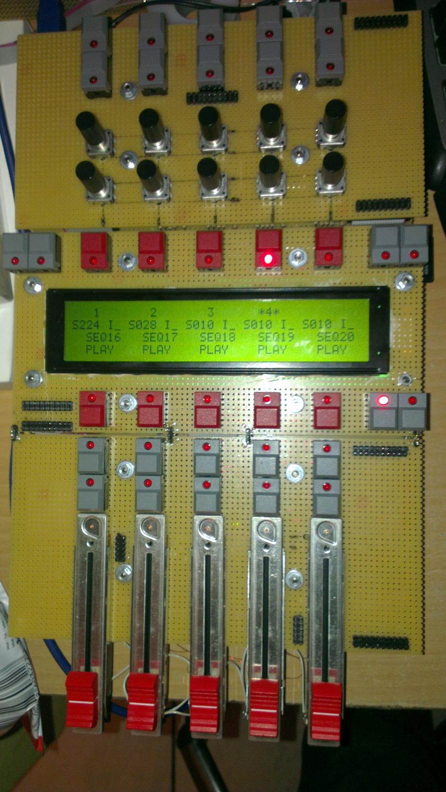

and here a image how the controller looks like now..
and as you see i have the 10 buttons on the TOP of the controller.
i like to have the same Function/CC note  if switch bank…
so if i’m on Bank 20 i can switch beteen bank 21,22,23,23,24,25,26 and 27 i need the same CC
on bank 30 i can switch between bank 30,31,32 and 33 i need a other CC then on Bank 20~27
on bank 40 i can switch between bank 40,41,42 and 43 i need a other CC then on 20~27 and 30~33
if i can use more then one bank on a Event this will reduce the amount of events allot..
i only need to copy it 3 times instead of 16 times..
kind regards, Spirit
