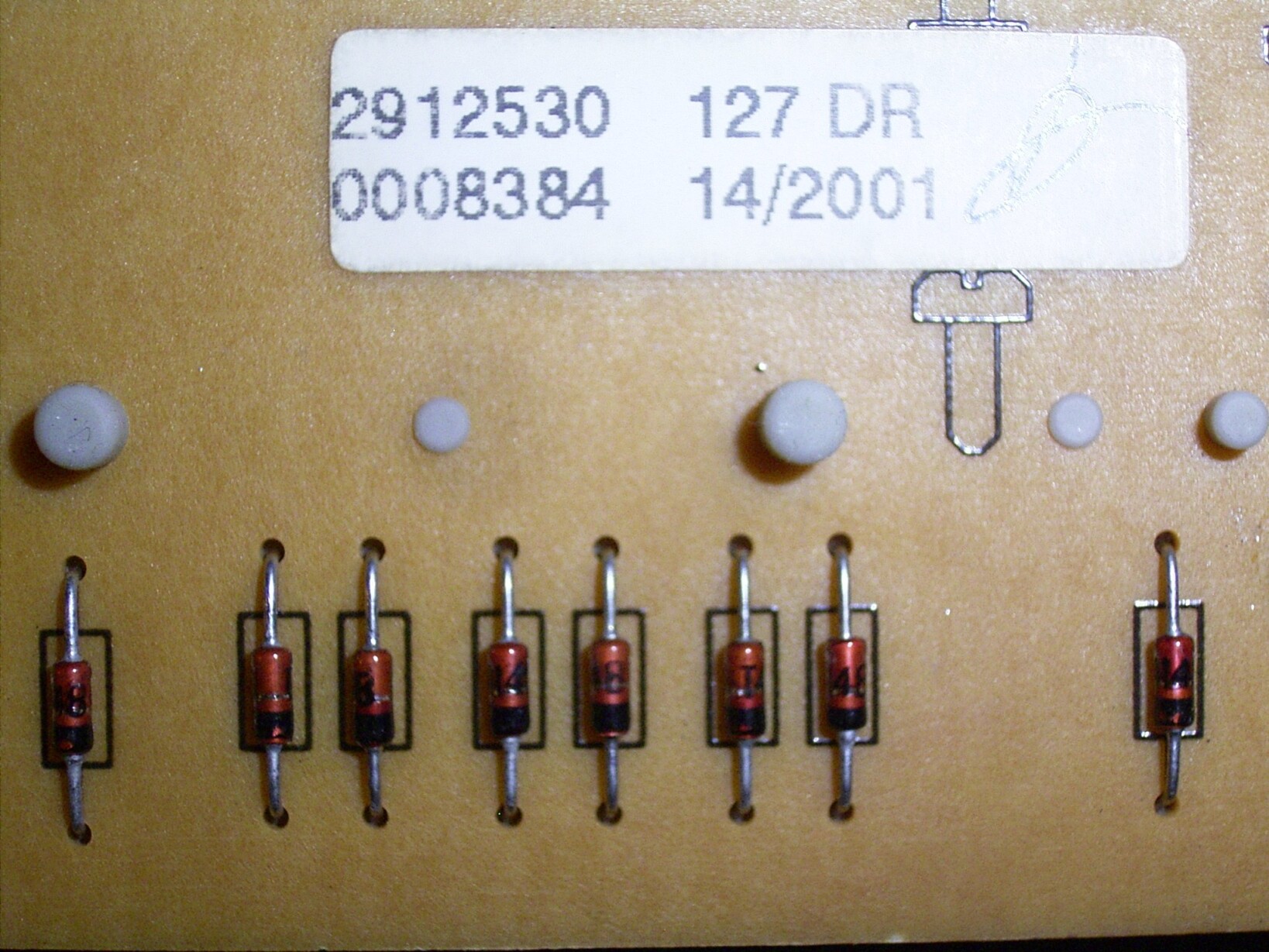

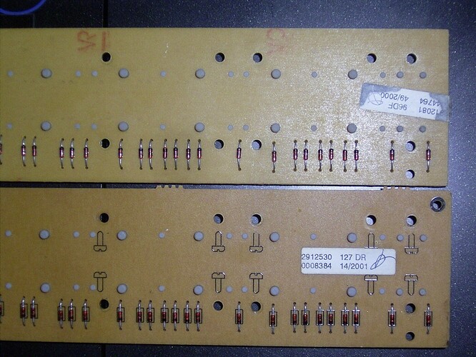

Here the back sides of the boards in comparison:
Is there a way to turn a Fatar DR contact board into a DF board?
