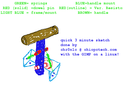

if you got some krafting skills and a few chunks of material and two springs you could make this.  i smiled when i read about your FRANKENFADER idea and it inspired this design using a potentiometer.  i am gonna draw this up in cad with real dimensions i think and build 1 or a few for my midibox project…
i know it looks like a 3 year old drew this but i did it in 3 minutes with the pencil tool and paintbrush tool for fill in gimp at a crappy resolution.  it’s only a rough idea.. the 3d cad is where i make it look sexy.
thanks for the inspiration, awesome idea ;)!
I like this frankenpot!!
You’d need to use some cogs or levers though, to get as much physical travel as possible out of the pot.
failing this, you could perhaps apply a voltage offset and gain using an op-amp.
otherwise you’ll need to use scaling, which leads to reduced resolution.

… there is some pots that only have limited travel with full range i believe.  i should look into this… 90 degrees would be do-able with zero at 45 or zero at zero.  this type of design would work with rotary multi-switches as well.  the hole through whatever panel it’s mounted behind can be just like a fader slot.

i made a prototype bracket today at work, brought it home and drilled a hole to mount the pot. in the side, rigged up an arm on it.  i’ll be looking into finding some 90 degrees pots soon…  i also went to harbor freight tools right down the street from me and looked for springs, all they had was a 200 pc. kit of a bunch of different springs and i don’t need 200 springs right now so i’ll just buy 1 or two springs from somewhere online.    i’ll take a pic when i get frankenpot-prototype-v2 done!
if anyone is interested in one or two of these maybe i can do a small number production run on them?
