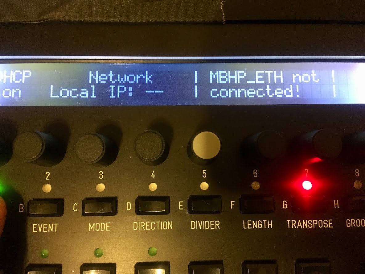

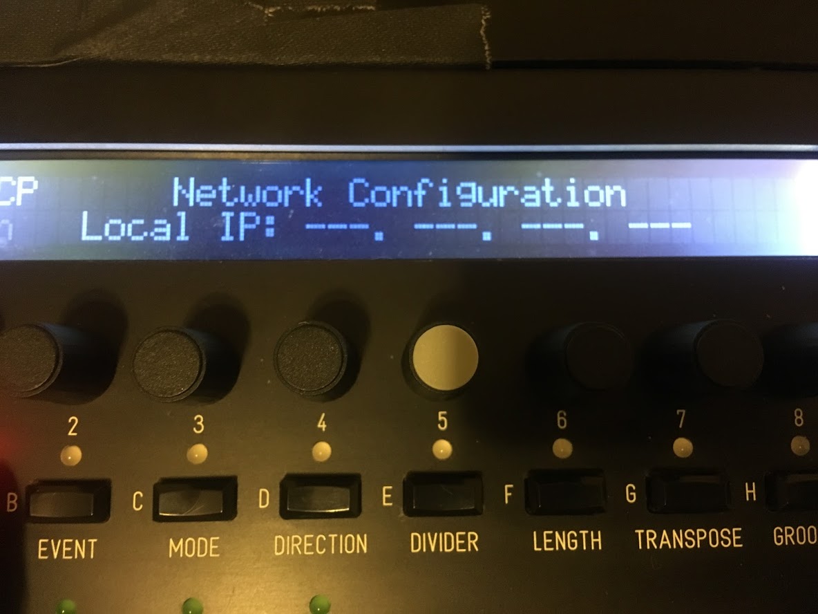

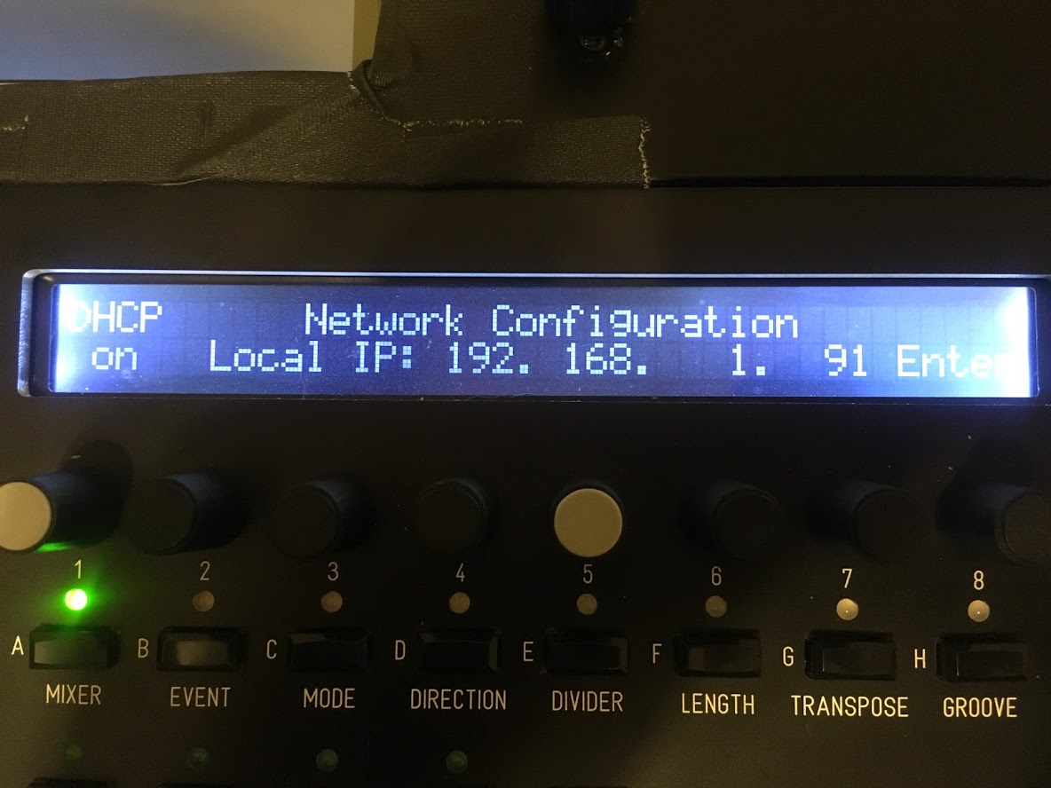

Hi, everyone! I LOVE my seq and I’m really impressed by this supportive community. I’m having an issue with my ENC28J60-based ethernet adapter, I bought this one:  https://www.amazon.com/gp/product/B00GAXAQOQ/ref=ppx_yo_dt_b_asin_title_o00_s00?ie=UTF8&psc=1 . It is able to get an IP address over DHCP, but if I try to play anything over OSC, soon after it loses its IP address. If I press the button to get an IP, it tells me the ethernet adapter is no longer connected. It will keep its IP address as long as I don’t try to play anything.
Any ideas? It has done the exact same thing with two different of these ENC28J60 adapters. Thanks for your support! I tell everyone how amazing this sequencer is, and people who see me play it are totally jealous. Any ideas you have on this are greatly appreciated. Photos follow.

MIOS32 still shows an IP address after the Seq display says it can’t find the ethernet adapter, but it says the cable is disconnected:

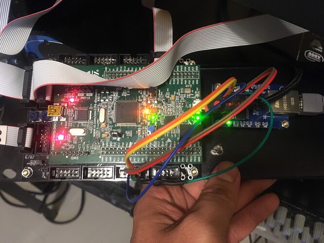

I just used a multimeter to test the voltage coming out of J16 -  it’s only 2.8 volts instead of 3.3. This really could be why - I’m trying to supply better voltage to the ethernet board to see if the problem clears up.
So, the under-voltage issue was totally why. One of my ethernet modules has a 5V input with a 3.3 volt regulator which I had bypassed to connect to J16. I un-bypassed the regulator (so I could connect 5v), and connected 5v from J2 - problem solved.
For anyone doing this in the future, these ethernet adapters work - but don’t bother trying to get 3.3 volts from the F4Discovery board - it only provides barely 3 volts. Use J2 5 volts instead if possible, otherwise use an external 3.3 volt power regulator.
