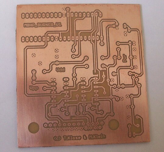

PIC burner transfer after etching in ferric chloride. Done some time ago. 2 days of experimentation. Coated paper used here (250 mg)
I bet that those guys with high rated replies have better transfers + etching jobs better than mine :slight_smile:
