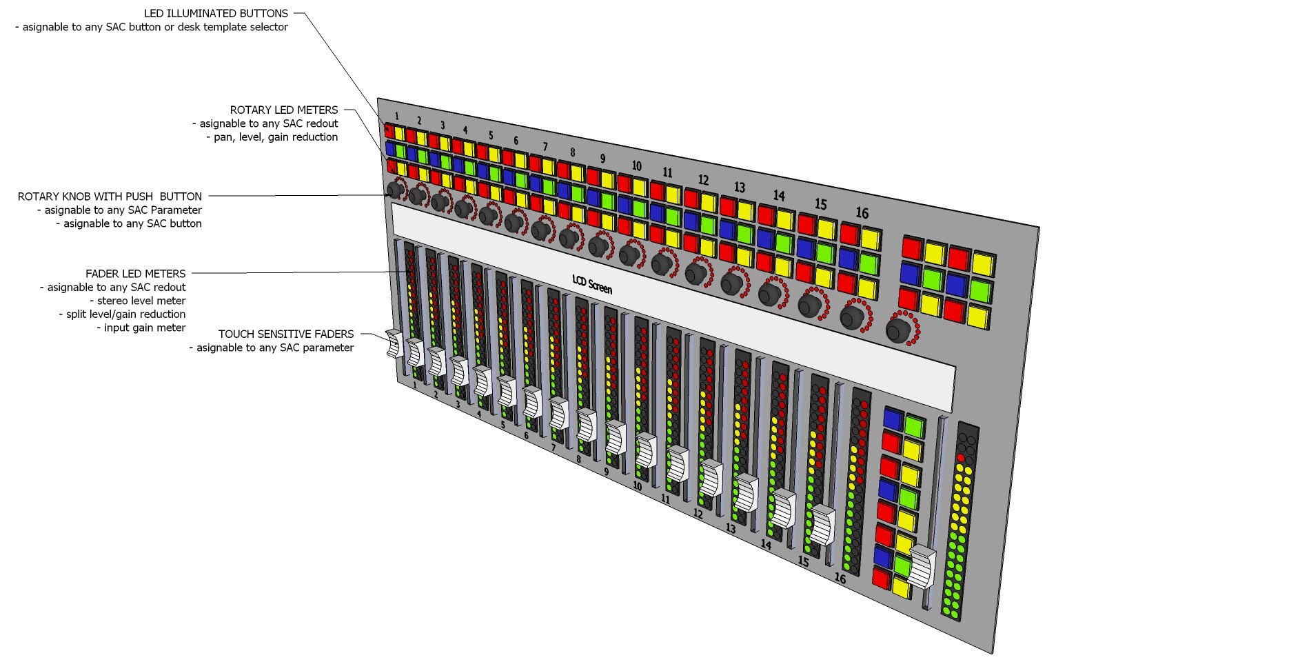

Hi there folks.
Here’s the quick sketch of a front panel. Today I’ll look at the modules to see which and how many do I have to wire together.
The controller has
17 Motorized Touch sensitive Faders
17 Push Pots with Rotary Led Meters.
1 Big LCD Screen, or 17 small ones
124 LED illuminated buttons (colors selectable in user GUI)
It should be a controller with it’s own brain, mixer changing, programmable through WebUI. For the main brain part I was thinking to use a Router. Routers have their GUI, fast CPU’s, 4 ports of LAN, wireless and linux embed. Seems like a great bundle of features for the task. Then the controller could be Wired or wireless out of the box. There is a whole community out there dedicated to programming/hacking Linux firmwares for many routers. I think I can find someone willing to contribute.

The controller has
17 is an unfortunate number, as MIDIbox modules support faders and buttons in multiples of 8.
Sounds like it’s not a MIDIbox anymore. The brain for a MIDIbox is always the core module, here it is most likely going to be the upcoming LPC17 core module - somewhat comparable to the STM32 but with Ethernet onboard. This is running MIOS, the OS, which serves all the modules attached to it. If you want to use a different “core”, like a router, you might be able to use the modules still, but you would have to write drivers etc. for those yourself. And, where would you want to connect the modules to?

I was thinking to patch the router before LPC17 (like a data mapper) to provide mixer switching and WebUI options. Kinda gateway mapper.
Br,
Dali
Now I understand! If it was my system I wouldn’t want another component in there. Two more cables, one more power supply…
But in order to get my controller working I would need huge amount of modules, that would need to get connected together. If I understand correctly, for bidirectional mode I must use DIN and DOUT modules for each LED button. For 124 Illuminated buttons only, I need 4 DIN and 4 DOUT modules. And if buttons have RBG colors that’s even more. One LPC17 can handle only 128 addresses if I’m not mistaken.
so for complete controller I would need something like:
2 x LPC17
6 x DIN
6 x DOUT
  • LCD modules
That’s huge amount of modules where each should be mounted somewhere and connected with wires. It would take too much space. What about designing a big motherboard and put all modules on one board? That seems the only workable solution as module count is so big.

Maybe the use of “modules” is the best way to keep the device modular.
The DIN and DOUT board are quite small.
But I agree with you that a mixed DIN/DOUT combining features of DIN and DOUT on a single module would be a nice idea and could lead to a new contribution here.
A big motherboard would probably be expensive because of small quantity and big size !!!
