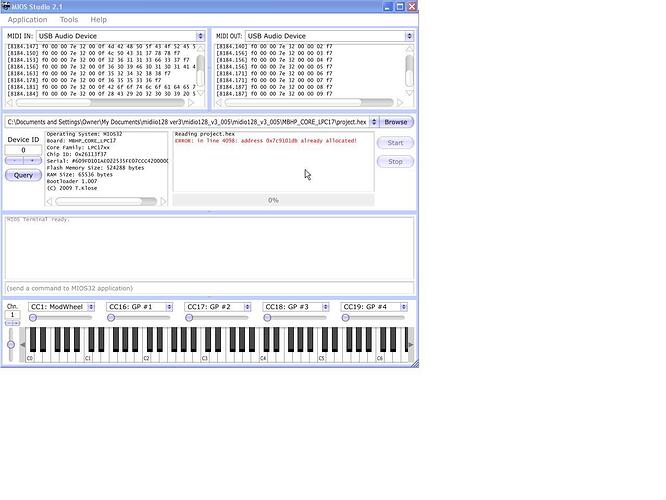

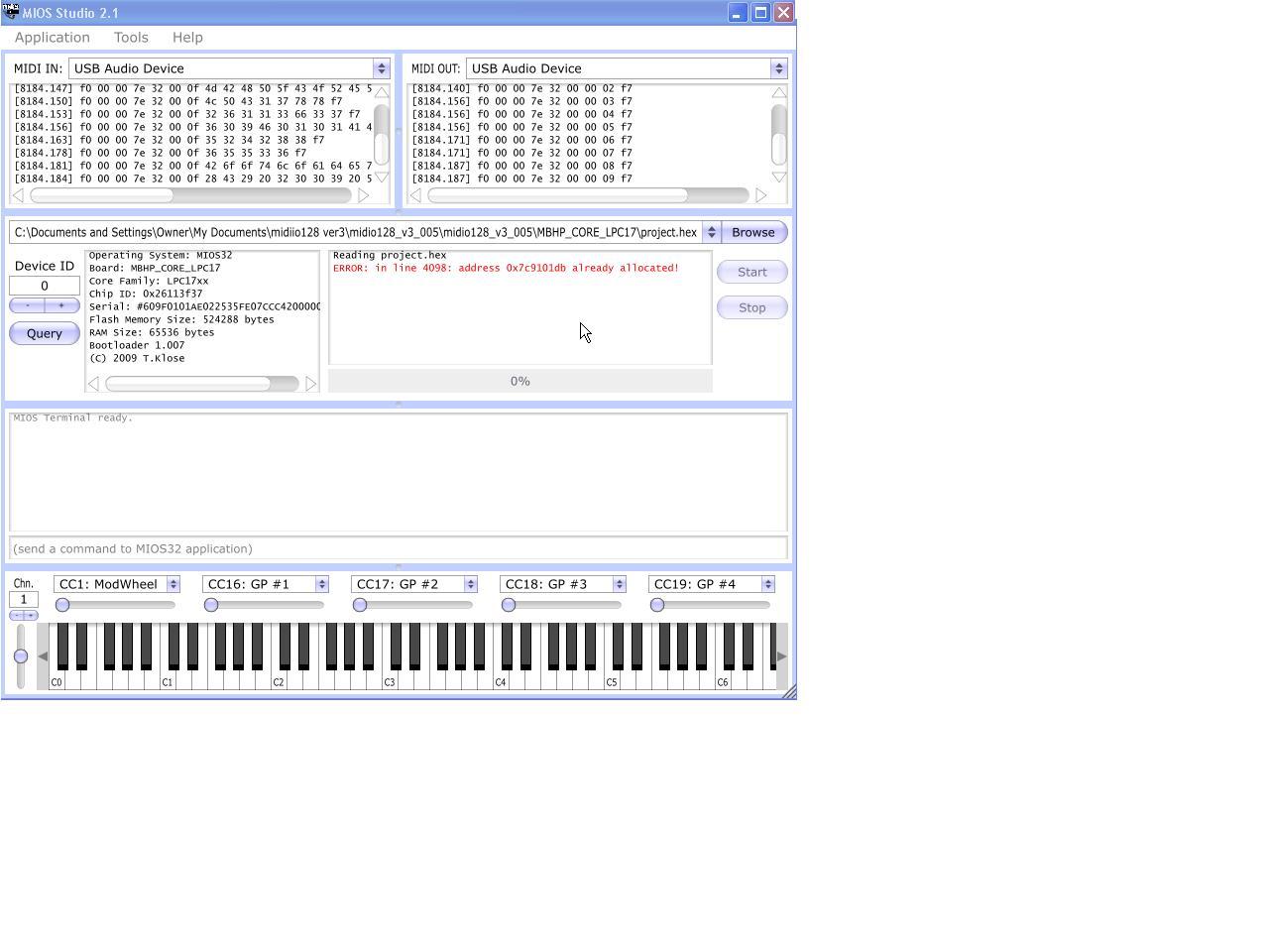

Error message on mios Studio loading midio128v3 on LPC17
Anyone:
Loading Midio128 ver.3 on my LPC17, the core is recognized and displays all the pertinent data, but after loading the hex file and pressing start, I get an error message, attached. The setup includes only the LPC core, no SD card, no CLCD, jumper J17 in place and jumper J15 positioned for 5V,USB power. I did the early voltage check on the core and got 3.26vdc, close but not exact.

Reloaded the bootloader,ver .007, and got new message;
Reading project.hex
project.hex contains 63208 bytes (248 blocks).
Range 0x7c910100-0x7c91f8ff (63488 bytes) - (unknown)
ERROR: Range check failed!
Notice that the start address in the Range: is the same as came up on the first error message.
TK - is this normal?

Hi John,
MIOS Studio 2.1 fails to parse the project.hex file and therefore outputs this error message.
Could you please try the upload with MIOS Studio 2.2.2?
Best Regards, Thorsten.

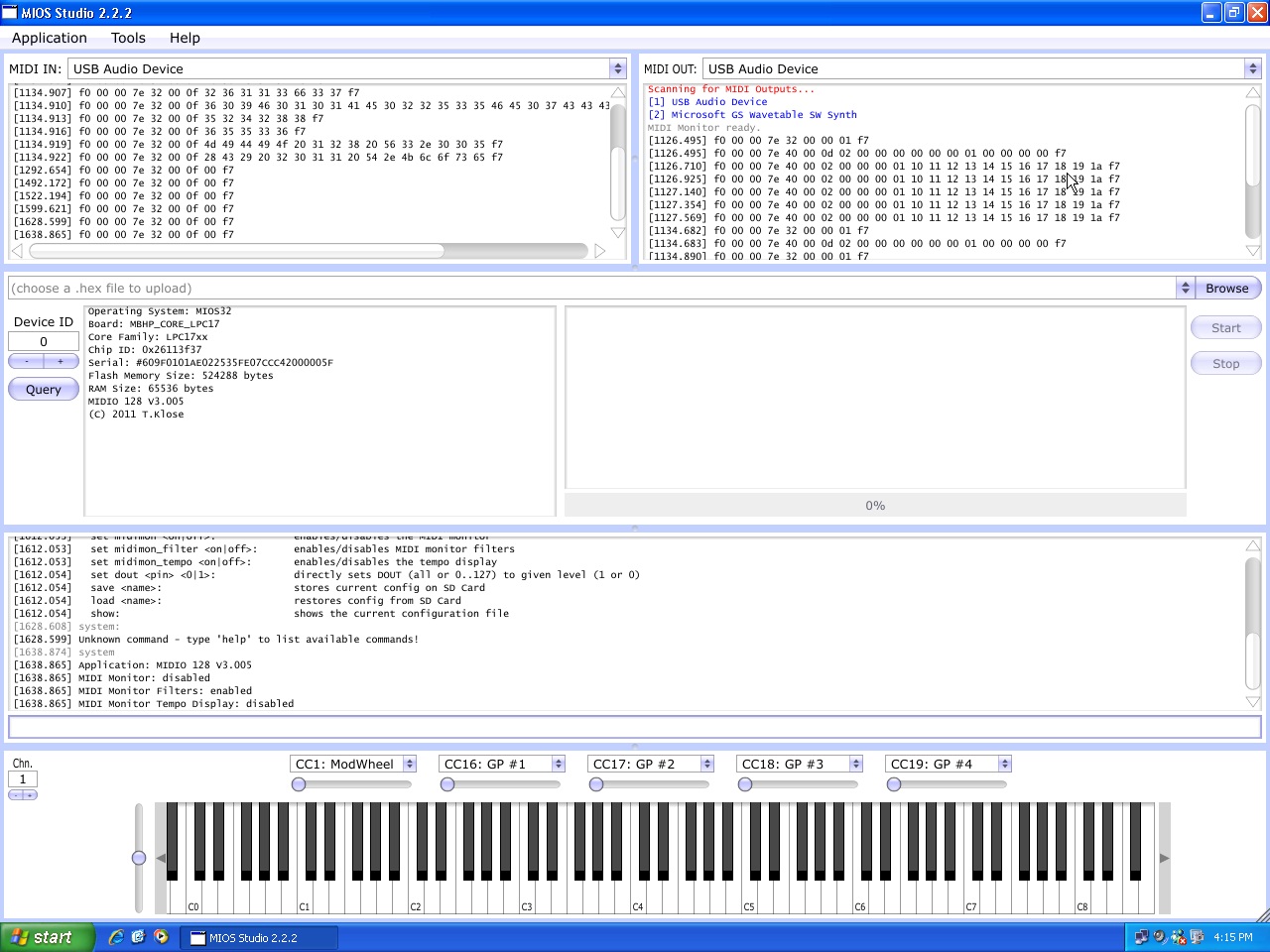

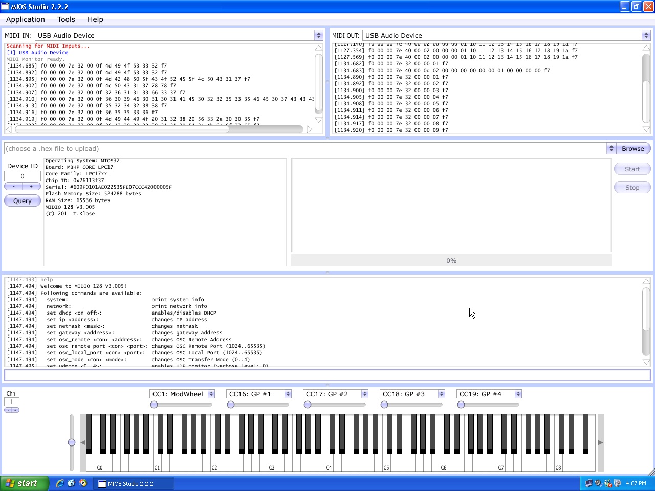

TK,
Midio128 is indeed loaded. See screen dumps below. I printed two so the complete mios terminal contents would showup. I also entered the system command, which produced the last few lines. Note the line that says “the midmon is disabled”. does this have any connection to my malfunctioning LCD?
Back to an earlier question - does the lack of the control surface components have any impact on the lack of display on the LCD?
Also, could I have damaged the HC595 also, and i suspect the answer is “Maybe”
I removed the LCD plug from J15A and moved it to J15b with no change in the LCD.
In the way of analysis - Can I assume that the USB/midi in/midi out circuitry
is ok since I got a good load of midio128?
Assuming the possibility of a bad solder joint, is the circuit area involving the J15a, j15B, hc595, core a reasonable area to check for bad connections?
Regarding the LCD contrast and luminance, with the contrast turned up, the 2 rows of 20 character squares appear. is this evidence of anything good regarding the HC595 and LCD?
Fine! :slight_smile:
No, this MIDI monitor function doesn’t get use of the LCD, it optionally prints incoming MIDI events into the MIOS terminal for debugging purposes.
no
it’s unlikely that the 74HC595 has been damaged if the LCD has been connected incorrectly.
J15B is intended for a second LCD (e.g. as used by the MIDIbox SEQ application).
MIDIO128 doesn’t initialize the second LCD, therefore it won’t work.
yes!
Yes, but from my experience it’s more likely that the LCD won’t work anymore, therefore I recommended to replace it.
No, the pots control analog voltages, and it’s normal that some squares appear after power-on, before the LCD has been initialized.
My assumption is, that “something” has been fried in the digital logic, therefore just order a new one - it will save you a lot of unnecessary debugging time.
Note that you could already configure the MIDIO128 application by editing the configuration file which is stored on SD Card.
