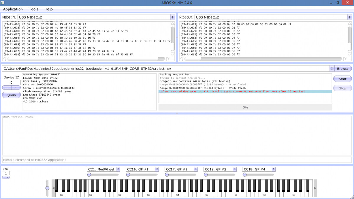

back in 2012 i started a project with the intention of creating a tactile midi controller for live use. i had to abandon it for different reasons but now have the time to revisit it. i have all the modules and components necessary for the seqv4 but am a little confused about loading the firmware. im using a stm32 based core with the USB and MIDI interface working great but im at a loss as to how to get my LCD up and running. when i try to upload hex files through MIOS studio i get this error: “Upload aborted due to error #14: Invalid SysEx commandNo response from core after 16 retries!”. has anyone experienced this error before? im sure its something really simple but i have no real experience with programming at all so im in the dark and dont know what i am looking for. if you need any particular information that would help in troubleshooting this just ask, id really hate to give up on this and would appreciate any pointers at all -

Hi Paul,
I guess that a very old bootloader version is running on the core, therefore please try to update to the latest bootloader V1.018 the following way:
  • enable bootloader hold mode with a jumper on J27 (it’s located between the two J15A/B sockets)
  • re-power the core module, re-start MIOS Studio
  • upload the mios32_bootloader_update_v1_018 application
  • if successfully uploaded: remove the J27 jumper
  • wait until the update happened (see README.txt of this application what should happen)
  • power-off the core
  • power-on the core, it could be that your OS (Windows?) needs some time to re-install the USB driver, because the USB device characteristics have changed in newer bootloader versions
  • start MIOS Studio
Now you should be able to upload newer applications which are available at the MIOS32 download page.
Best Regards, Thorsten.

so after updating the bootloader i was able to successfully upload the SEQv4 firmware…
