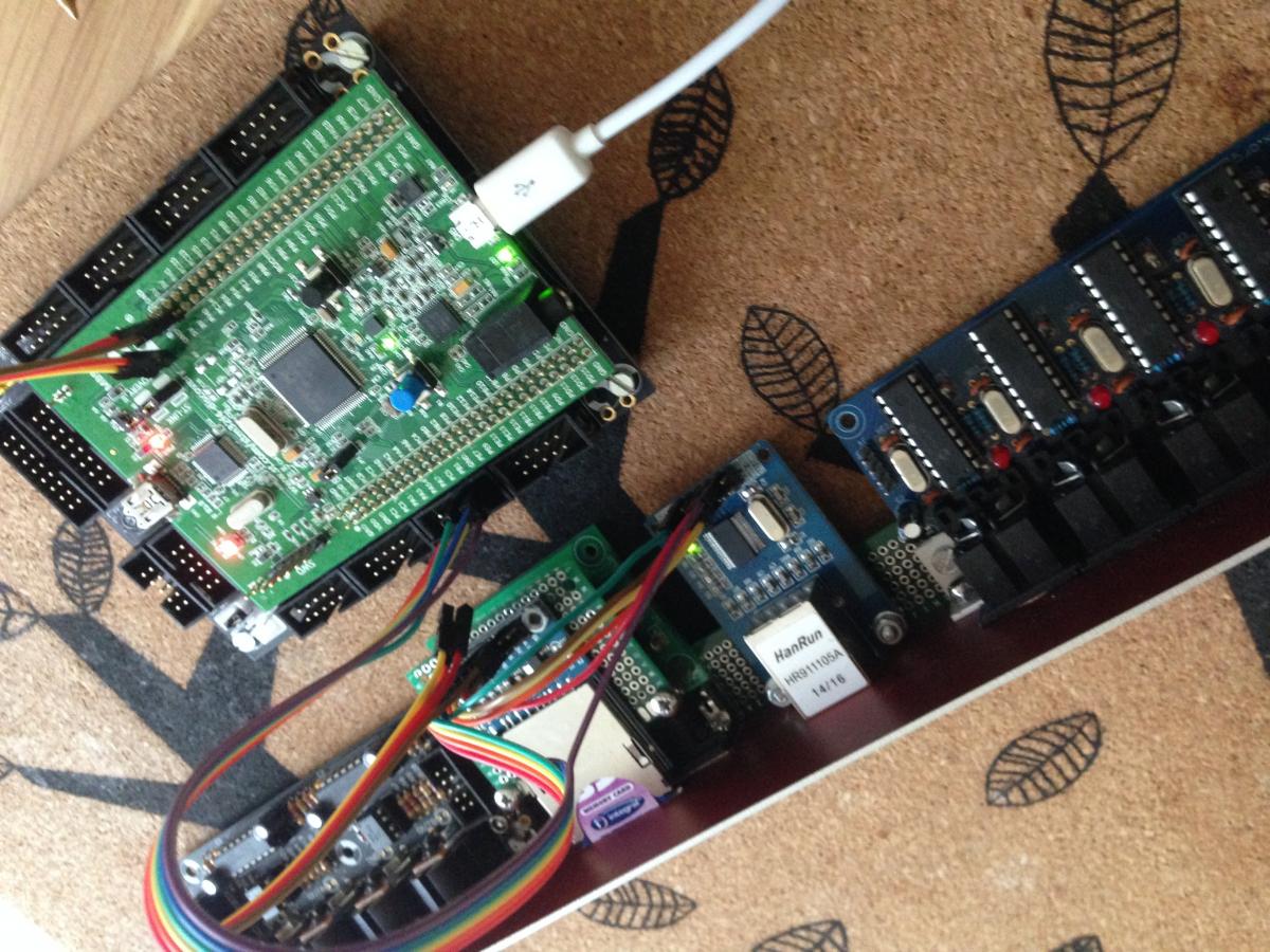

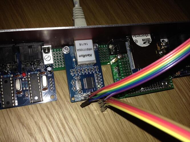

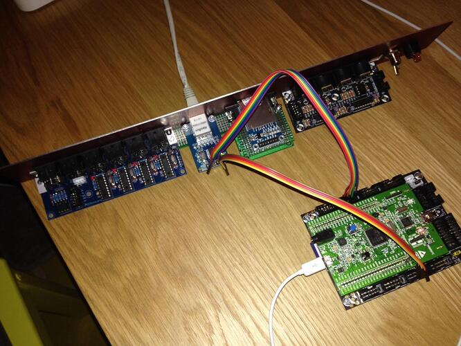

After a bit of messing about and learning the basics of how SPI works I have been able to successfully connect a SD Card and the ENC28J60 board simultaneously to J16 of a SMT32F4 core.
