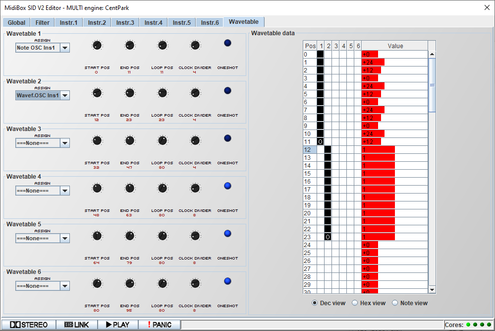

I’m trying out Rutghers Java Editor and can’t figure out how to make an Arp with the Wavetables for the Last Ninja 2 Central Park Loader.
While the wavetables are more advanced on the MIDIbox SID V2 I think they are harder to program than Insidious. These are just my initial thoughts.

I figured out 2 settings which were messing up the wavetables, Instrument 1 in Multi Engine was set to Poly instead of Mono.
And the “Wavetable Only” was not enabled in Rutgers Editor.
Almost have the Central Park Arp sounding the same now except I get notes that are too high pitched.
I’ll post the results in my next post below.
So the above is the result I get from MIDI track 1 (attached). Some unexpected high notes.
[Central Park Loader.mid](< base_url >/applications/core/interface/file/attachment.php?id=16035&key=026adf038eaeec3c85cfdcf0b8617fbd)
Basically in wavetable 1, I’m copying straight from the video, Step 1 =0, Step 2 = +2 octaves, Step 3 = +1 Octave and repeated for the 12 steps.
In Wavetable 2, I want the Triangle Waveform to play on each of the 12 steps. So in hexidecimal it should be a value of 01 on each step?
I know that theres probably other ways of selecting the triangle wave but I’m trying to copy the video and understand how to put in the values.
It could also be an issue with my MB-6582 causing unexpected behavior, I need to resolder joints as I get some noise at times.
Any help would be appreciated, thanks. :slight_smile:
[CentPark.syx](< base_url >/applications/core/interface/file/attachment.php?id=16039&key=f0f49e1101cd8cccada0bb858b21cad1)
(Almost) well done! :)
Quote
I would propose to define a 13th step (at position #12) which transposes by +0 (-> no transpose), and to set the loop point there. This ensures it won’t be transposed further.
Alternatively try Oneshot mode.
Quote
yes
