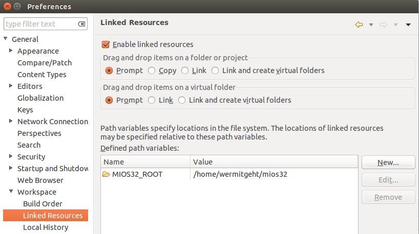

DO YOU SEE ANY FAILS ON THE SCREENSHOTS:

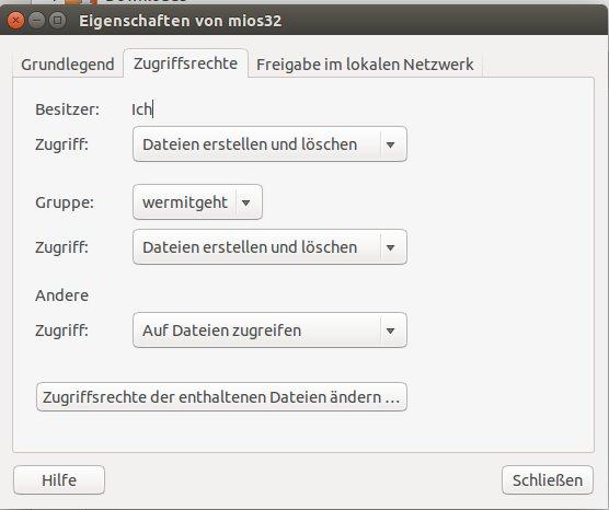

I put the mios32toolchain to:
/home/wermitgeht/mios32
these are the write read rights:

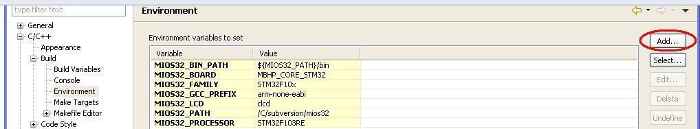

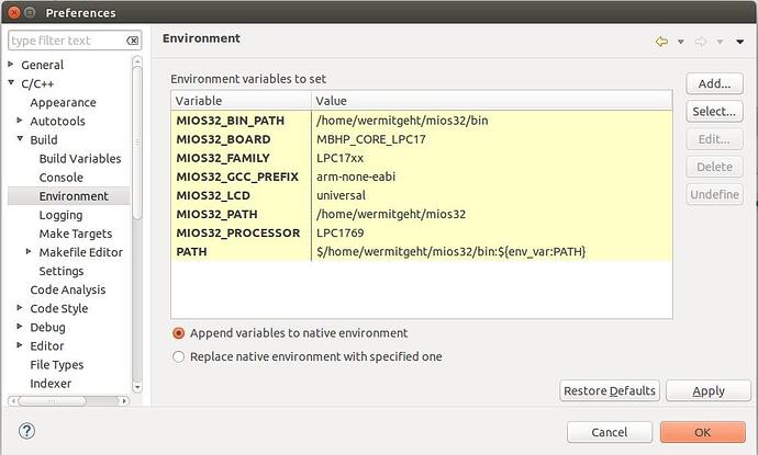

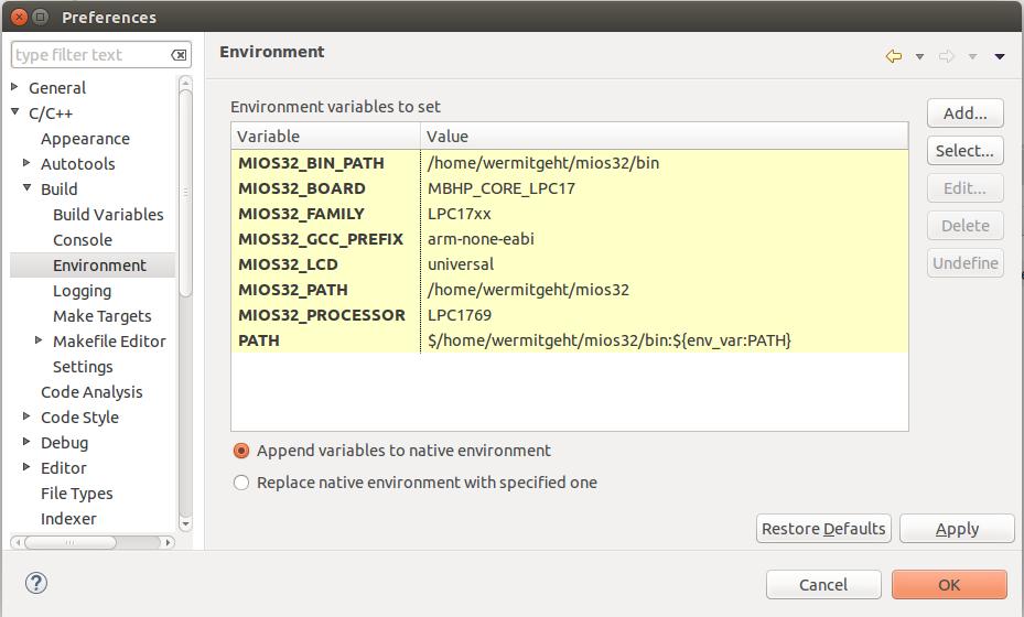

in eclipse i set this settings:
& this:

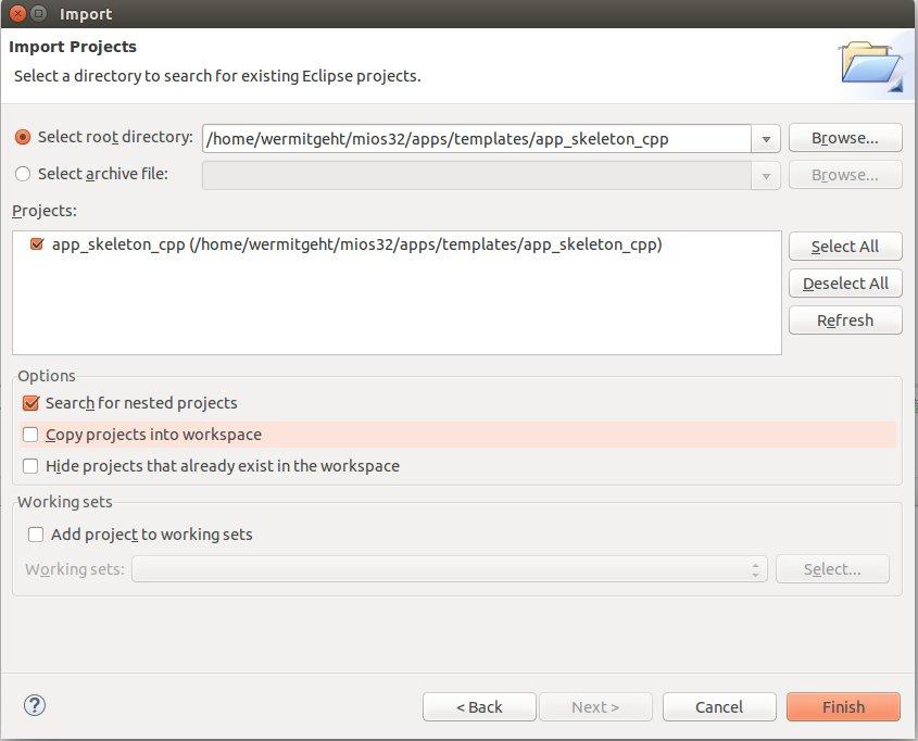

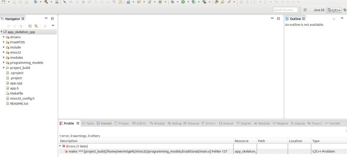

then I imported the app_skeleton_cpp

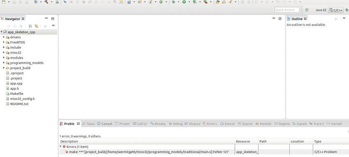

after right-click on the skeleton - then leftclick on “project build”
I got error 127

but hey dont need… written in this Tutorial: http://www.midibox.org/dokuwiki/doku.php?id=eclipse
You can define Environment variables that will only be used by Eclipse. You can use this feature instead of modifying the operating system environment variables. To define Environment variables, select C/C++→Build→Environment in the ‘Preferences’ window and click the ‘Add’ button on the right. These environment variables will automatically apply to all projects in the workspace, and you can override them on a per-project basis by modifying the projects’ configurations.
${HOME}/mios32_toolchain/bin:${env_var:PATH}
up to now hardstuff that everyday when I try to get this run - ends by NOTHING, end by the frustrationt “to not wrote a single code line”…
I have tryed it on a windows computer, and also get sucked on this variables, i finally made a Batchfile… in ubuntu i get sucked by trying to do the same (scribt).
please take  a look on my screenshots - do you see any Fails? do you need more details - what?
The error 127 is a C/C++ error. So you will need to check on command line to see what goes wrong. Could very well be a dependency missing or something like that.

12:42:36 **** Build of configuration Default for project app_skeleton_cpp ****
make all
rm -f project.hex
Creating object file for main.c
make: arm-none-eabi-gcc: Kommando nicht gefunden
make: *** [project_build//home/wermitgeht/mios32/programming_models/traditional/main.o] Fehler 127
12:42:36 Build Finished (took 173ms)
Kommando nicht gefunden = (command not found)

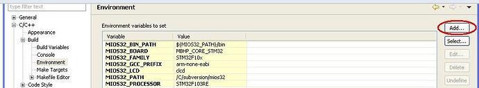

TUTORIAL SCREENSHOT from: http://www.midibox.org/dokuwiki/doku.php?id=eclipse

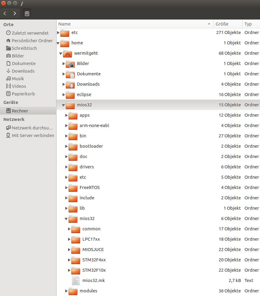

like on my very 1st picture my Path is: /home/wermitgeht/mios32
I come from max-msp - so i may know some stractions, may know that $ give us something like a variable — but I am absulutely new to C for uC and of Course Eclipse.

In this Tutorialhttp://www.midibox.org/dokuwiki/doku.php?id=eclipse is written:
For Linux, add a variable ‘PATH’
my “arm-none-eabi-gcc” is under: /home/wermitgeht/mios32/bin
So how to write the Value of Variable “PATH” correct?
${HOME}/mios32/bin:${env_var:PATH}
${HOME}/wermitgeht/mios32/bin:${env_var:PATH}
${HOME/wermitgeht/mios32/bin}:${env_var:PATH}
$HOME/wermitgeht/mios32/bin:${env_var:PATH}
${HOME/wermitgeht/mios32/}bin:${env_var:PATH}
I dont have a glue - because of not understanding this $ ( ): $ (env_var:Path) thing
linux box and set the PATH
I dont have to set this in Linux when I set in Eclipse (thats what the Tutorial says)? (I will not set this temporary Thing every time i restart the Laptop, and for set this for “always” i dont have the linux knowledge to do that-as already said)

in aclipse I ereased then the Path Variable  - because it override the system Variables (i read that anywhere)
So have to clear this variable in Eclipse?
but error is still the same:

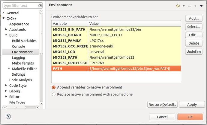

then I deletet all Variables in eclipse
then i build - i become following error:
18:33:50 **** Incremental Build of configuration Default for project app_skeleton_cpp ****
make all
Makefile:53: /programming_models/traditional/programming_model.mk: Datei oder Verzeichnis nicht gefunden
Makefile:56: /modules/app_lcd//app_lcd.mk: Datei oder Verzeichnis nicht gefunden
Makefile:60: /include/makefile/common.mk: Datei oder Verzeichnis nicht gefunden
make: *** Keine Regel, um »/include/makefile/common.mk« zu erstellen.  Schluss.
18:33:50 Build Finished (took 172ms)

in eclipse i still get some missing Folders/Files when  i build:
19:46:27 **** Build of configuration Default for project midibox_seq_v4 ****
make all
Makefile:146: /programming_models/traditional/programming_model.mk: Datei oder Verzeichnis nicht gefunden
Makefile:149: /modules/app_lcd//app_lcd.mk: Datei oder Verzeichnis nicht gefunden
Makefile:152: /modules/blm/blm.mk: Datei oder Verzeichnis nicht gefunden
Makefile:155: /modules/blm_x/blm_x.mk: Datei oder Verzeichnis nicht gefunden
Makefile:158: /modules/aout/aout.mk: Datei oder Verzeichnis nicht gefunden
Makefile:161: /modules/sequencer/sequencer.mk: Datei oder Verzeichnis nicht gefunden
Makefile:164: /modules/notestack/notestack.mk: Datei oder Verzeichnis nicht gefunden
Makefile:167: /modules/midifile/midifile.mk: Datei oder Verzeichnis nicht gefunden
Makefile:170: /modules/fatfs/fatfs.mk: Datei oder Verzeichnis nicht gefunden
Makefile:173: /modules/file/file.mk: Datei oder Verzeichnis nicht gefunden
Makefile:176: /modules/random/random.mk: Datei oder Verzeichnis nicht gefunden
Makefile:179: /modules/freertos_utils/freertos_utils.mk: Datei oder Verzeichnis nicht gefunden
Makefile:182: /modules/uip/uip.mk: Datei oder Verzeichnis nicht gefunden
Makefile:185: /modules/uip_task_standard/uip_task_standard.mk: Datei oder Verzeichnis nicht gefunden
Makefile:189: /include/makefile/common.mk: Datei oder Verzeichnis nicht gefunden
19:46:27 Build Finished (took 78ms)
