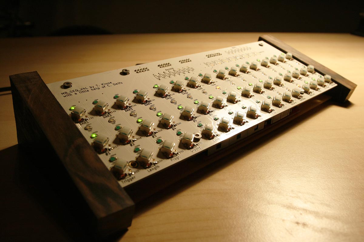

Hola,
The white PCB looks so yummy, that I did not want to hide it :slight_smile:
Just had some fun soldering a few SMD LEDs and sawing two leftover pieces of ebony wood.
The transistors and the resistors were soldered to the backside of the frontpanel PCB, because I would not like them on top.
Also, I am playing with the idea of powering it with two AA batteries, using a voltage step-up converter - I successfully already burned two of those converters while experimenting :slight_smile:
The ´lite is a real great live seq, just had a first testing session @ the midified piano, and it was very nice - hoping for a demo soon!
The tactile switches are “softtouch” ALPS SMD switches, available for 6€ per 100 pieces somewhere on ebay, they have a very nice feeling and do fit perfectly when mounted diagonally, which adds to the chaotic look :slight_smile:
The SMD LEDs are green and orange, which I also had leftover - they are very easy to solder on the existing LED pads.
Thanks to everyone involved in this project, CD for the initial idea + pcb layouting, TK for the realization, SmashTV for production and fast shipping!
Have lots of fun with your lites, this one is official #76 :slight_smile:
Best regards,
Peter
This thing looks HUGE on photo while I know it’s so tiny…

nice wood sheeks. im thinking on the same on mine but with the acryl frontplate to protect my pcb.

Yo Peter!
Are these the switches you used?
http://www.ebay.de/itm/100x-ALPS-SKPM-SMD-Taster-softfeeling-/300649328602?pt=Bauteile&hash=item460018afda
Yo flip! :slight_smile:
that´s kindof them, same seller as I bought from (recommended!)…
Mine were white (but also from alps and softtouch), but they should have the same size, so I am quite sure, that these will work fine, if you are not scared of mounting them diagonally :slight_smile:
The price is very good for the quality, they are really precise when pressed and have an excellent tactile feeling :slight_smile:
