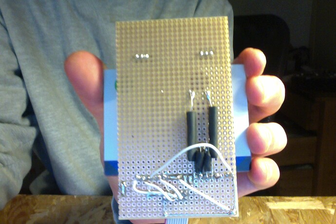

Okay, so i tried making it work today. Made a small proto-board to mount the display on and i think i have made the right connection. If i measure on it, there is 3.3 v where there should be.
I have updated the bootloader config to the dog_glcd and set the resolution to 160x104 and it seemed to say it stored it and when booting the core the MIOS terminal says initializing LCD #1, so i think it got it.
I tried running the 021_glcd tutorial and i have updated my ~/.profile and set the lcd to the uc1610. In there as far as i could see the resolution was already set to 160x104, so that should be in order. The code compiles, but when i try to plug in the display and boot the display shows nothing. I haven’t got the backlight, but i would imagine that something would still be showing or some sort of sign of life? It should show the “Tutorial #021” (…), but it doesn’t.. I am not sure how to debug this.
Here is two pictures (The ribbon cable goes to LPC1769 core J15)
and
hi istel,
very adventurous construction btw… anyway first i would change the display-driver in ~/.profile from uc1610 to universal and re-compile everything. next i believe, that pin26 is connected to GND instead of 3.3v. the 100nF cap on pin17 is missing, whereas it should work without that, and im not really sure about the other caps. if you have used electrolytic caps, as it looks to me, make sure the polarity is right, otherwise it cant work…
mOnO
Hehehe! Yes, slightly adventurous! Now it works - i see how it looks a little funny, but i think everything is wired up correctly now.. The error was the caps - i had read the wrong value in the schematic, i thought it say 0.2 uf and not 2 uf :slight_smile: swapped them out and now it works!

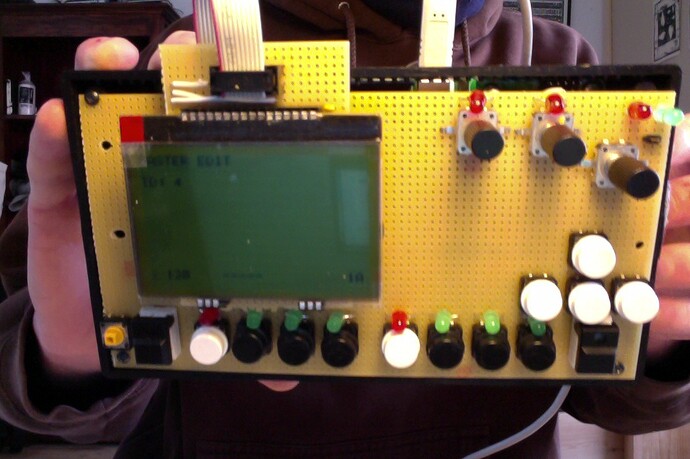

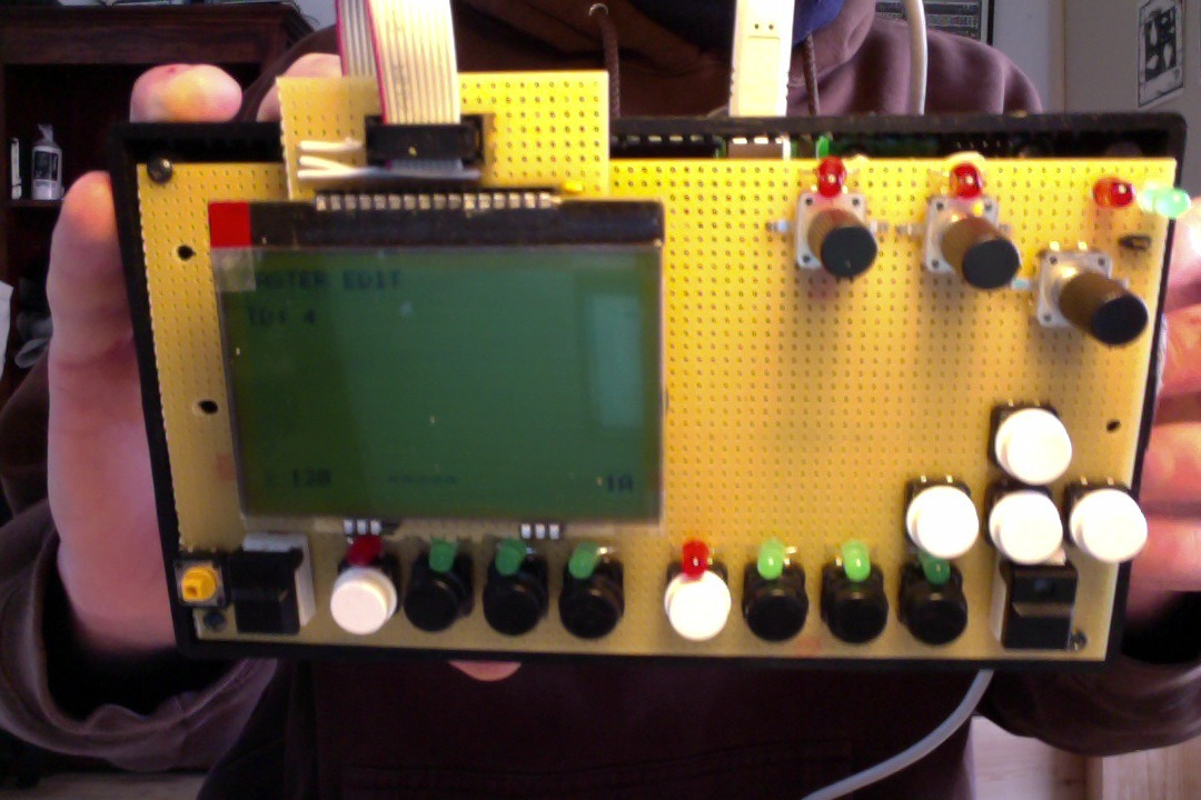

Yeah, this is so nice!! Before it was only a 2x16 CLCD, but this can show so much more info!!
But we are having slight issues - we are two persons working on the software, one OS X and the other is Linux. Every time my friend tries to send an application to the device the screen will fail, and we have to flash the bootloader, update LCD settings and then send the application from my computer (OS X). Is there somewhere where the bootloader config is being set without us knowing? It seems that everytime he tries to send over the application something is being reconfigured with the LCD and it has to be set back to DOG_GLCD, etc etc..
Here is the prototype (!) :slight_smile:
