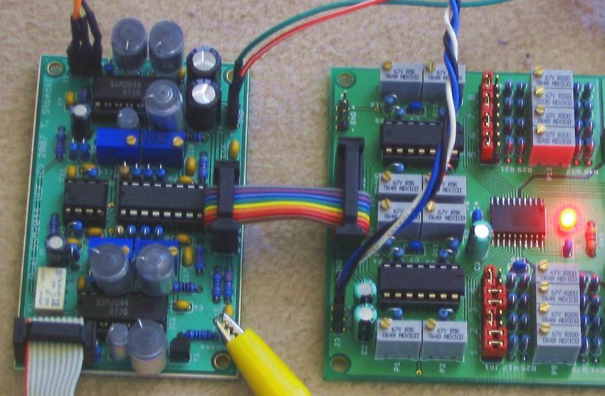

Hi,
some of the chat regulars have already heard about it, but I thought I’d should write a forum post about this project, too :slight_smile:
In the last months I designed a dual SSM2044 filter PCB for use with e.g. MBSID V2. This PCB contains two of the famous SSM2044 24dB low pass filters with the necessary cirquitry, additional LM13700 based Q linearization cirquit and a tiny Omron micro relay for a software controlled (via gate out pins) bypass function. The layout is optimized for use with the AOUT_NG module, requiring the addition of a bipolar option when used with regular V/Oct sources like the original AOUT module.
Some pics:
Short audio demo: http://www.seppoman.de/stuff/SSMtest2.mp3
That’s MBSID V2 with 6581 SIDs, “Bassline Demo2” default patch with SID filters turned off. First a sweep without resonance, then a bit of resonance and high resonance. Last a sweep up short before oscillation and down with oscillation (beware of high volume, the end is a bit distorted because of clipping ;))
The PCB still isn’t final - got the supply connector wrong way for connection to the AOUT_NG, and you might have noticed that I did underestimate the size of 10nF Styroflex capacitors :wink:
That’s it for now,
Seppoman

Constructive criticism:  would it not be a good idea to make a board that has 4 filters instead of 2?  Then if a person decided they only needed 2 filters, they would only need to populate half the board.
I’m still really excited and glad you’re moving forward with this, but I would need to make 4 of these for my MB-6582, which would mean more redundant parts and more spaghetti.
I suggest 4 filters because if you’re controlling cutoff and resonance with control voltages, one AOUT_NG would drive 4 filters.
Yes but for MB-SID V2, you still need one AOUT_NG per Core, two Cores can’t share one AOUT_NG to control two filters… although it might be possible for TK to do some magic and make this happen (route one Core’s AOUT modulation to a different Core via CAN?)
or better: control volume and feedback with the “extra” aout channels
I briefly thought about a quad board, but as Wilba said, MBSid doesn’t support more than two filters per core so you’ll need to have 4 AOUTs anyway. I don’t think sending envelopes via CAN to another core would be feasible without impact on the general performance. Spaghetti factor is actually quite low. Except for the audio and bypass connection, you can put the ssm board side by side with the NG and just have a few short wires. Two is a good number in my opinion, suitable for the SID while not making the PCB unnecessarily big for people building e.g. only a single stereo MBSID.
Also, on this PCB there would be virtually no parts to save with a quad version (ok, two polarized capacitors…), it’d essentially be twice the board as it is plus more complicated routing, i.e. more than double the size. And btw, this pcb is 8x5 cm, the few SSM2044 modules out there in the modular world usually are double the size with only one VCF, so I’m actually quite proud on the form factor ;)  Except for a few wires less, there’d be nothing to be gained from a quad pcb.
If you mean unneeded parts on the AOUTs, you could either build only half of an AOUT or an AOUT_NG with only channels 1-4 stuffed and only channel 1 and 3 with bipolar option.
