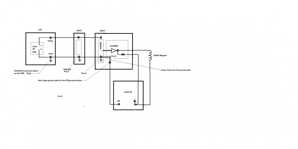

Duggle, Pete,
Take a look at the attached sketch.
As long as the only point of connection between the two loops is the new ground lug that i show on the DOUT pcb, the high current loop involving the 12vdc PS, magnet coil and driver on the ULN and the 5vdc loop though the I/o cabling should remain separate.  When the ULN conducts the voltage from pin 9 (gnd) to any of the output pins drops to less then 1 volt and the current from pin 9 to any one of the output pin goes up to 200 - 300ma.  Pin 9 on the ULN  must be connected to pin 8 on the 595 which is at ground plane potential, however the current flow will be normal.
Adding  a high current jumper from pin 9 on the ULN to the new grond lug, ot a beefier trace will do the job. and minimize voltage drop in the loop, so that the voltage across the magnet is as high as possible.
Johnc
The drawing looks right, to me.
