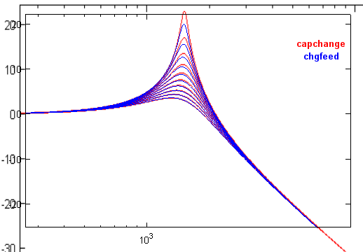

The slope does not change according to the simulation. That’s why I am asking about how valid that schematic is. I haven’t run “official” measurements on the SID and hoped someone else had already done enough testing to confirm.
According to that schematic, changing the resonance using only feedback from the first integrator block (what the RES register does) follows this pattern:
http://www.skrasoft.com/blog/blogfiles/chgfeed.png
…and changing the resonance using only changes in the external capacitor values follows this pattern:
http://www.skrasoft.com/blog/blogfiles/capchange.png
It just looks like the same standard resonance both ways, with no effect on the filter order (slope).

I dunno, it looks pretty different in those pics?
Try the same scales (see attached).
Yeh I thought that might be it, but there is a difference in the slope even in your image…

Which tiny difference? The maximum resonance difference between changing cap values and changing the RES register that in those graphs is not accurate. Those are just a couple simulations I ran with arbitrary values to show that both cap ratios and the RES register control resonance in the same manner. With the right cap values simulated I could make them line up perfectly, but that wasn’t what I was trying to show.
I don’t think we’re talking about the same thing when we say “slope.” I’m talking about the db/oct of the filter. That does not change at all in the pictures I posted. The transfer function gets a peak at the cutoff frequency, but that is normal resonance. You mentioned messing with harmonics that was bad for sound design, but unless you consider resonance as a general concept to be bad then I’m not sure what you meant with regards to changing cap values.
