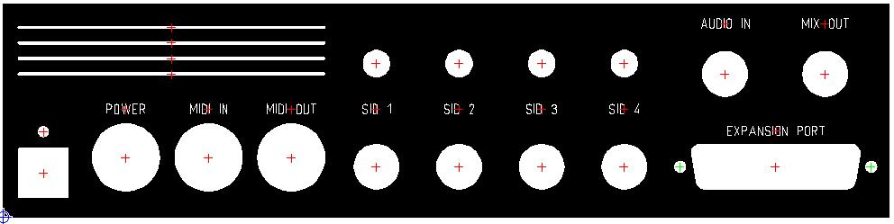

My plan is to use heat spreaders (like Hawkey) in combination with ventilation slots below the voltage regulators (seen on pics from Wilba) and use the backpanel space (where the fan was intended) for additional 6.3mm audio-in and the mix-out jack.

Thanks guys for your feedback! In the meantime I ordered panels at Schaeffer. I’m going to try it first with four 1mm thick ventilation slots and no fan opening, see attached picture.
