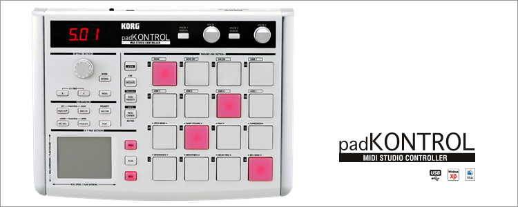

hum…finaly, this product appear to be less soft two hours after getting it out from the oven, i will try to warm it less than this first time…it’s still soft , but not enough in my opinion for doing mpc style pads..using directly the RTV silicone will be better for this purpose (i’ve already do test that lead to great result, the only thing that stop me is that i can’t find appr. mold - if someone own some square plastic box that can be used for that…).
the advantage of this product is that you can do transparent soft button, to be used with a backlight LED…
yeah, like this padKontrol by Korg.
