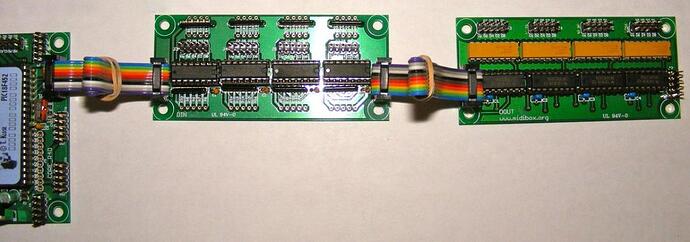

The two rows of pins @ J1 and J2 on the DIN boards from my shop are different, one row has the SO pin the other has the SI pin:
This can be an problem for guys who wire direct/without connectors or use single row connectors since it is easy to get on the wrong row.
I realize this seems like an error or bad design at first look - but it facilitates a mixed DIN/DOUT chain with simple 1:1 IDC connectors and ribbon cable saving hours of fiddly SIL connector crimping:
http://discourse.midibox.org/t/topic/16057
