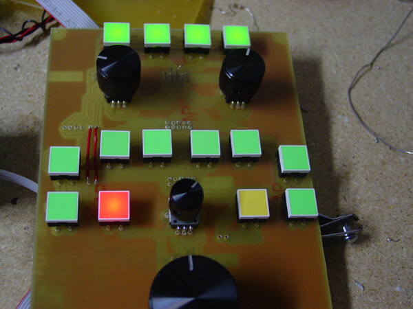

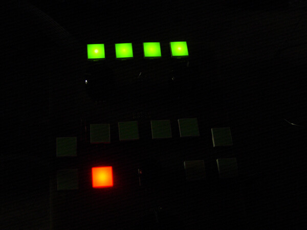

Hello All,
Today I’m testing out a board I made for my traktor controller (MB64E) .
As you can see when i plug my board into one of the SR’s of the DOUT  Module the lights are lit up.
I only want them to light up when i press them and go out when i press them again.
I searched through the main.asm file and a few other files in the MB64E application but I cant find where to set these prefrences.
say I have a button connected to SR2 Pin 0  on the DIN Module what corresponding pin must I have the LED connected to on the DOUT Module?
Thanks Alot,
VILLADON

Ok just to make sure I’m correct here,  this is what I got:
4 Buttons, 2 Encs on SR2 of DIN
8 Buttons on SR3 of DIN
The built in LEDs on the 4 buttons are connected to SR1 DOUT
and the 8 buttons are connected to SR2 of DOUT
I made these changes with no success.
#define DEFAULT_DOUT_SR_PIN_01_08      1
#define DEFAULT_DOUT_SR_PIN_09_16      2
#define DEFAULT_DOUT_SR_PIN_17_24      0
The rest are set to ‘0’ also
Any Ideas?
VILLADON
Are all *LEDRING* settings assigned to 0 (disabled)?
Best Regards, Thorsten.
