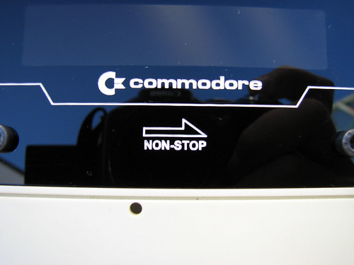

This is my latest creation. You all know what I modified. :slight_smile: Not completely finished as I need to wait Saturday to buy DIN connectors.
Mechanical counter will be put back in place and power LED needs to be connected.
Leaver of mechanical buttons are used to activate micro switches mounted at the same button holder plate that is cut out of the rest of the mechanics. Doors are swapped with piece of “smoked” transparent acrylic that is masked at the back and rest is sprayed with black paint. Only masked center for display is left clear. Writings are engraved and filled with acrylic paint. I add 4 hex screws more for aesthetically reasons than even they are holding the door against the rest of the casing. I need to think of some name for it to add it between door and buttons, so if you have some cool name for it in your mind you are welcome to propose it. Or I`ll call it just Data SID…
Here are few pix…

I love that “Non-Stop” marker…
