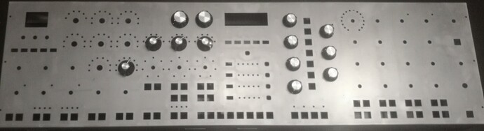

I am starting my next project, which is a patchable Model D clone controlled by CVs. I am adding extra LFOs controlled by CV. Totally I will need 48 8bit and 7 12bit CV, scan 48pots and 70 buttons in matrix, drive 250 leds, 50 direct outputs. Also I want to connect 4x20 character OLED display. I assume that for that number of IO I will need 2 NG boards. Is it possible to send MIDI CC parameters where 2 CC channels are merged and allowing of sending 8bit values?
The chassis is in progress.
