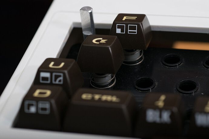

I’m still working out how I’m arranging the front panel. It’s based on a C64* keyboard with the encoders and switches being on the keyboard grid and the LEDs around it coming out of the C64* case surface. See image. Because of this I think none of possible arrangements will work for or against direct wiring vs matrix wiring. I think I’d rather deal with wiring 2 matrices then buy more DIN and DOUT boards and they required components for them (though I do have one DIN module completed from my since abandoned modular MIDIBox SID.
*Actually its a VIC-20 keyboard and case, but I’m pretending is from a C64.
