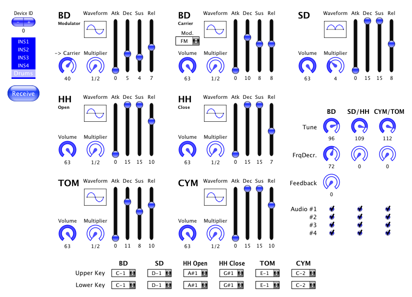

Update: Drums can now be edited as well:
The URL to the release package is identical:
-> http://www.ucapps.de/midibox_fm/midibox_fm_ctrlr_panel.zip
Best Regards, Thorsten.

TK, firstly I want to say thanks a lot for the Ctrlr editor for MBFM, I’ve been using it a lot over the last week and it really does help to integrate the synth into my DAW :slight_smile:
But unfortunately I seem to have a problem editing the drums. I’m using Ctrlr 965 on Mac OS X (10.6.8) and I tried both as a VSTi inside of Cubase Artist 6 and standalone. I click the drum page button on the left of the Ctrlr Editor and the drum controls show up. But nothing makes any difference to the synth (the normal Inst1 page is working fine to edit a normal instrument though).
I checked the MIDI which is being sent out and I noticed that the <type> byte is different between the InsX pages and the drums page.
This is what I see in the Ctrlr MIDI monitor when I move a control on the inst page:
f0 00 00 7e 49 01 06 08 00 14 01 f7
This is what is sent from moving a control on the drum page:
f0 00 00 7e 49 01 06 18 00 10 04 f7
Is the 18 at the 8th position correct?
Does anyone else have the drum page working?
Also, I noticed that when I use Ctrlr as a VST, the Ins1 to 4 and drum buttons open up the correct pages. But in the standalone those buttons don’t make a change! Maybe it is a Ctrlr bug, but I thought I’d mention it here as well…
