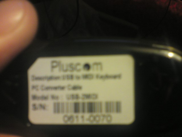

I’m actually using a usb to midi cable by a company called plus com,
should i be using something better?

Do you have a picture of this MIDI interface?

here is a picture it has male midi out and mid in and a usb plug

Alright, it looks like this interface (MIDI cable at one side, USB cable at other side, case has similar shape and three LEDs)
It’s on the blacklist .
If it isn’t already too late: send it back and complain about the bugs - meanwhile I read from many users (not only in this forum) that SysEx transfers are not handled reliable by this cheapo interface.
