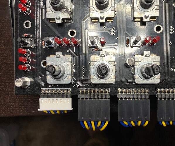

They look to be about half the height of standard DuPont connectors, so they should fit nicely inside a closed PT-10 case.

There was a modification that used right angle SIL headers that was interesting. Still very cramped but it worked, and allowed the panel to be separated from the base if needed.

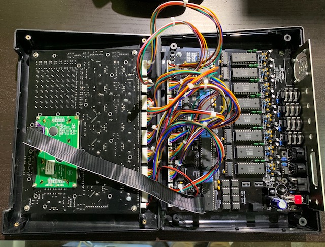

Just as I expected, the 100mm JST XH cables are a much nicer fit (and look), but what’s most important is they leave enough room for the case to close properly.
Now I feel comfortable recommending this solution to anyone that’s looking for quick removal access to service their control surface.

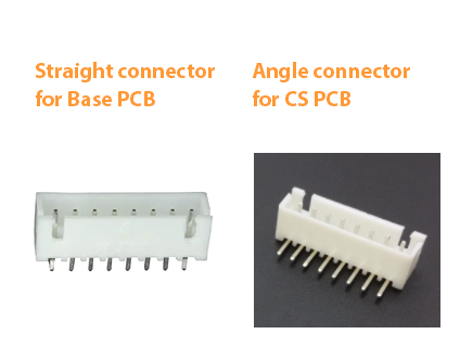

It looks like from the photos you use regular straight and right angle SIL connectors? I noticed the linked JSTs appear to include the straight connectors but I couldn’t find right angled ones. Any suggestion on options there?

I ordered the angled JST XH connectors from AliExpress, but they haven’t shown up in the mail yet (usually takes about 5-6 weeks to make their way into the US from Asia).
https://www.aliexpress.com/item/4000029760504.html?spm=a2g0s.9042311.0.0.349a4c4dKTIGpV
So, for now I’m using standard angled SIL headers, which seem to do the trick. The mount is flush and the connections are solid.
